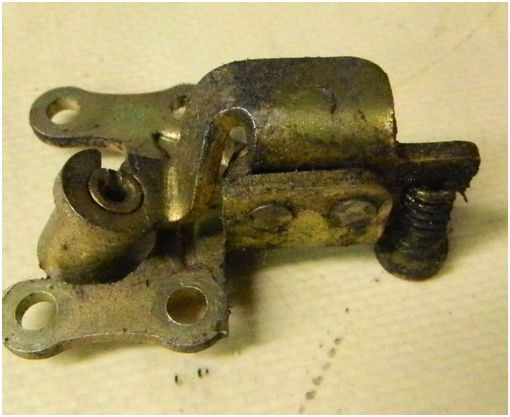

KIC Posted September 13, 2016 Share #28 Posted September 13, 2016 I still probably have the part you need. I just need to know EXACTLY which part it is. If somebody could circle the part that is needed, I will look through my carb part box and see if I can grab it. It just seems like there is confusion as to the exact part Gary is looking for.. Is this the actual part needed ???? Link to comment Share on other sites More sharing options...
luvmy40 Posted September 13, 2016 Share #29 Posted September 13, 2016 That's it! Link to comment Share on other sites More sharing options...
luvmy40 Posted September 13, 2016 Share #30 Posted September 13, 2016 Well, That's the part missing in the OP pic. Link to comment Share on other sites More sharing options...
garyS-NJ Posted September 13, 2016 Author Share #31 Posted September 13, 2016 Yes that's the part, thanks all, but my guy says he found it in the garage so I should be good to go. I ended up buying an e clip assortment off amazon Sent from my VS987 using Tapatalk Link to comment Share on other sites More sharing options...
