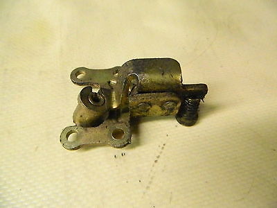

yamagrl Posted September 5, 2016 #12 Posted September 5, 2016 garyS-NJ said: http://uploads.tapatalk-cdn.com/20160902/2278e588ddb074842aac1647c3035380.jpg Sent from my VS987 using Tapatalk I think this is what you need. http://www.ebay.com/itm/89-Yamaha-XVZ1300-XVZ-13-1300-Venture-choke-cable-cabel-bracket-carb-carburetor-/311621467205?hash=item488e163c45:m:mP7olVkzNGq45M-ogfMXQkQ&vxp=mtr

garyS-NJ Posted September 5, 2016 Author #14 Posted September 5, 2016 Thanks but I don't need the cable holders, I need one of the flat rectangular plates. Sent from my VS987 using Tapatalk
yamagrl Posted September 5, 2016 #15 Posted September 5, 2016 garyS-NJ said: Thanks but I don't need the cable holders, I need one of the flat rectangular plates. Sent from my VS987 using Tapatalk That is the bracket for the left side. There is only one rectangular bracket and it goes on the left bank.
garyS-NJ Posted September 5, 2016 Author #17 Posted September 5, 2016 Holy smokes, are you sure? Seemed those flat brackets would hold each two carb bank (fore to aft) together and then the side brackets hold the left bank to the right. Parts fische on boats.com doesn't show the plates at all. Sent from my VS987 using Tapatalk
yamagrl Posted September 5, 2016 #18 Posted September 5, 2016 garyS-NJ said: Holy smokes, are you sure? Seemed those flat brackets would hold each two carb bank (fore to aft) together and then the side brackets hold the left bank to the right. Parts fische on boats.com doesn't show the plates at all. Sent from my VS987 using Tapatalk Yep. The right bank has a simple rectangular bracket but left side bracket not only racks #2 to #1 but also provides cable guide.

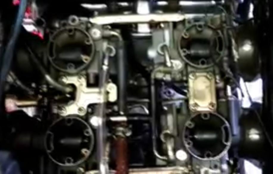

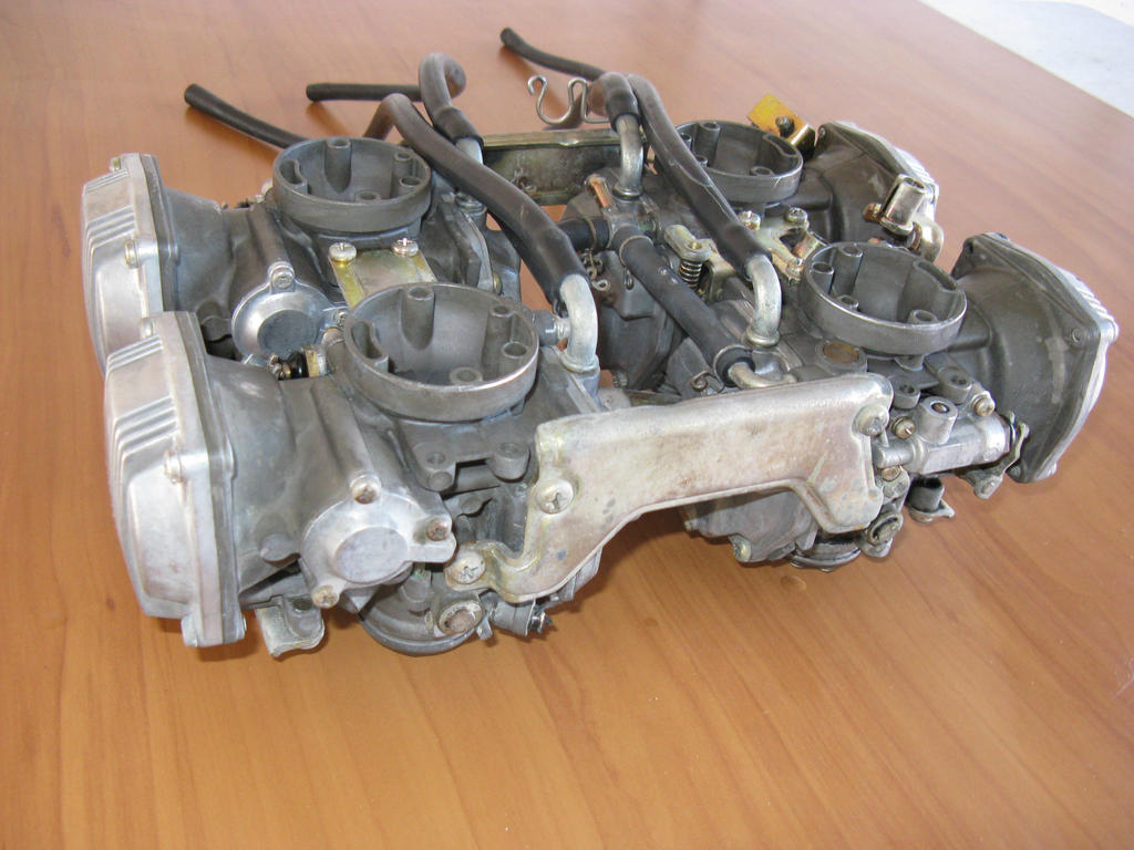

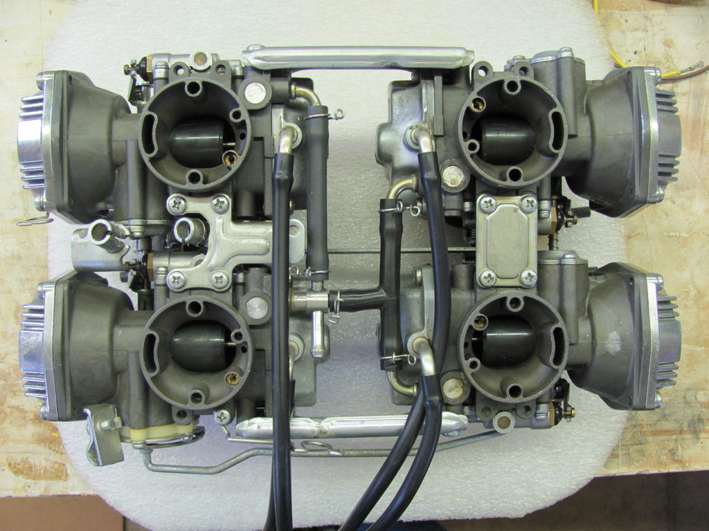

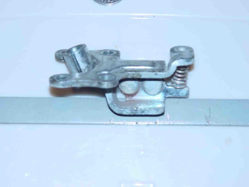

Prairiehammer Posted September 6, 2016 #19 Posted September 6, 2016 (edited) Yamagrl is correct. Here's a clearer picture of 1983 cabs showing that bracket. And a picture of 1991 carbs shot from a lower angle, showing that bracket in a semi-profile. It is not a simple plate as the right side is. Here is another shot of that bracket. It serves a throttle cable holder as well as joining the carbs. This is from a VMX12. Same as XVZ13/12. Edited September 6, 2016 by Prairiehammer
