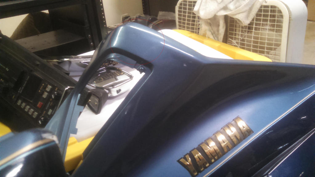

NewbeeMC9 Posted August 25, 2016 #1 Posted August 25, 2016 Any painting tips and tricks for the ABS? Gotta paint a cover, would like it to look 5-10 foot decent. Not worried about show quality, but best I can on the cheap. Thanks
