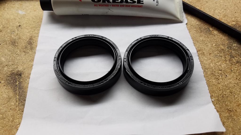

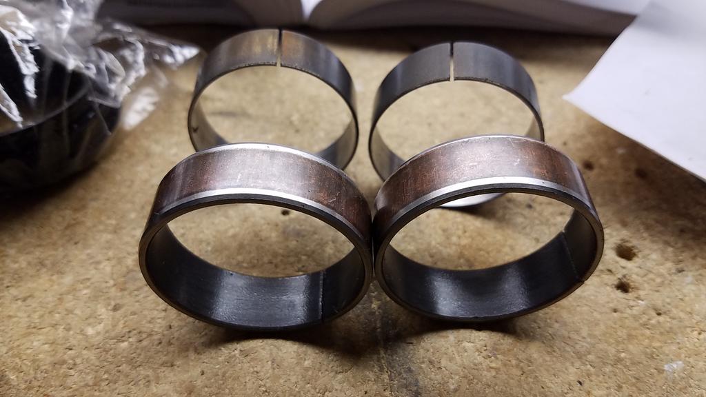

videoarizona Posted August 25, 2016 Author #26 Posted August 25, 2016 (edited) Update: Got the forks back in two hours. Barely had time for breakfast. To make me feel better, I ordered all the new bushings as well as the seals and dust covers. A bit more $$, but since I was there anyway.... As it turns out, I asked for and got the old parts back...negligible wear on the bushings and what wear there was was even all around...so bushings were wearing perfectly and had lots of life left. Not bad for over 50K miles and 12 years. As can be seen...the bushing surface is worn evenly. If it wasn't, you would see the "copper looking coating?" worn off in places. There is a slight bit of that on upper left bushing near the joint...which is normal. The oil seals looked great on both sides. No tears or nicks...just some dirt. So a good cleaning would have been sufficient. But I feel better they were all replaced. Steering bearings were right on the money and greased. In going back together, I was stumped for a few minutes trying to figure out how to apply 90 + pounds of torque to the stem head nut without help. Finally, the light bulb went off and I stuck a screwdriver in the two holes provided for us to padlock our forks. Worked. So did that, moved both forks up to the 1 inch mark for lowering the front end, tightened the lower tree and then removed the top triple tree (grunt & still had screwdriver in hole) to put the upper fork covers, washer and bumper on. Did that, tightened the uppers and then put the upper triple tree on for good. Removed the screwdriver from lock hole and put on the front fender. Stopped there for the day. Tired and need to think about how the front tire came out as it doesn't want to go back in. Nothing changed in lift height so I guess I'm simply to tired to "finess it" properly. BTW, the dealer...Ride Now Power Sports at Ina road in Tucson has only seen one RSV in the past few years...mine. First time for an oil change and complete go over after I bought the scoot and now today. But they went by the book... and seem to have done a good job. Won't really know until I get on the road again. Guy said it came apart and went back together the way they all should.... More later....I need a libation....in celebration of getting this far, of course. What were you thinking? Grins! Edited August 25, 2016 by videoarizona

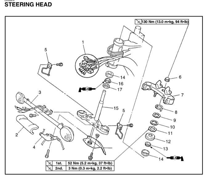

Guest Jamsie Posted August 26, 2016 #28 Posted August 26, 2016 ! thing to look out for . when torquing the strearing bearings , you tighten the ring nut to 37 ft/lb. to make sure the bearings are fully seated ( i would also rotate stearing back and forth to make sure ) then slacked off a little and re-tighten to 2.2 ft/lb
