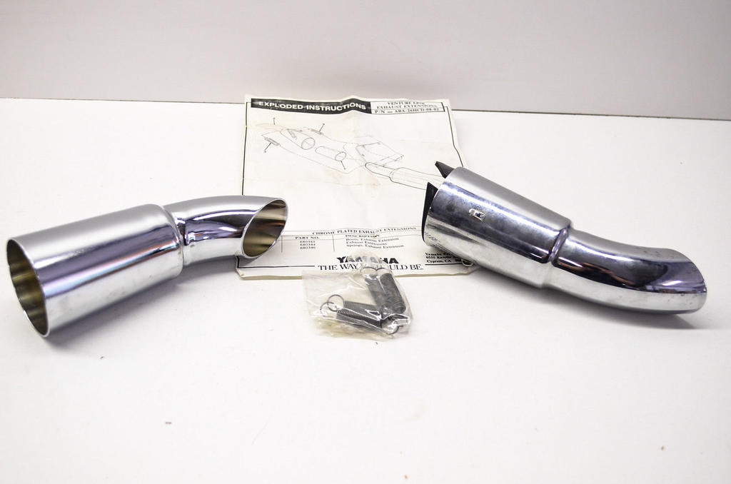

luvmy40 Posted September 16, 2016 Author Posted September 16, 2016 Got the carbs all back together and installed yesterday or so and finished up with the air box and cables and such this evening. Applied about 3/4 enricher, turned the key on, remembered I had the petcock turned off, turned the key off, opened the fuel petcock and tried again! Key on, "choke" on, fuel on. Hit the starter and turned her over for about 20 seconds when she caught and rumbled to life! It sounds much better but I only ran it for 30 seconds or so as I have absolutely no ventilation in my garage. I need to mover her back outside to tune the pilot circuits and synchronize the carbs. Then to button up all the plastic...I should have taken some pictures, huh? Been there before. I'll figure it out. BTW, the exhaust tips for a 1986 XVZ1300 are ever so slightly different that the ones for my 83 1200. Maybe it's because I have the big chrome rear skirt? I don't know. They look almost identical and the fit on the mufflers perfectly but the connection points for the spring retainers are different and wont work with the springs that came with them. I tapped one on as tight as I could get it without damaging it and bent up a couple springs. I got them to kind of fit but they're certainly not right. Hopefully they stay in place and keep the tip from falling completely off if it loosens up. They really aren't doing anything to hold it on though. I may just drill a hole from the bottom and run a self tapping screw up into it.
Prairiehammer Posted September 16, 2016 Posted September 16, 2016 BTW, the exhaust tips for a 1986 XVZ1300 are ever so slightly different that the ones for my 83 1200. Maybe it's because I have the big chrome rear skirt? I don't know. They look almost identical and the fit on the mufflers perfectly but the connection points for the spring retainers are different and wont work with the springs that came with them. I tapped one on as tight as I could get it without damaging it and bent up a couple springs. I got them to kind of fit but they're certainly not right. Hopefully they stay in place and keep the tip from falling completely off if it loosens up. They really aren't doing anything to hold it on though. I may just drill a hole from the bottom and run a self tapping screw up into it. The exhaust downturn tips for the 1986 are OEM for those later Ventures, whereas the exhaust downturns for the 1983 were a Yamaha aftermarket accessory (ABA-26HCD-08-02) intended to be used with the Yamaha "Deluxe Saddlebag Trim Rail" (ABA-26HCD-08-01). The springs for the aftermarket downturns for the 1983, attach to the downturns and to the Saddlebag Trim Rail, thus springs from the 1986 factory downturns (which attach at loops on the downturns and to a loop on the 1986 muffler) are incorrect for attaching the downturns to the Saddlebag Trim Rail of the 1983. Trim Rail, Saddlebag, VentureLine, MKI, ABA-26HCD-08-01 instructions.pdf
NewbeeMC9 Posted September 16, 2016 Posted September 16, 2016 Got the carbs all back together and installed yesterday or so and finished up with the air box and cables and such this evening. Applied about 3/4 enricher, turned the key on, remembered I had the petcock turned off, turned the key off, opened the fuel petcock and tried again! Key on, "choke" on, fuel on. Hit the starter and turned her over for about 20 seconds when she caught and rumbled to life! It sounds much better but I only ran it for 30 seconds or so as I have absolutely no ventilation in my garage. I need to mover her back outside to tune the pilot circuits and synchronize the carbs. Then to button up all the plastic...I should have taken some pictures, huh? Been there before. I'll figure it out. BTW, the exhaust tips for a 1986 XVZ1300 are ever so slightly different that the ones for my 83 1200. Maybe it's because I have the big chrome rear skirt? I don't know. They look almost identical and the fit on the mufflers perfectly but the connection points for the spring retainers are different and wont work with the springs that came with them. I tapped one on as tight as I could get it without damaging it and bent up a couple springs. I got them to kind of fit but they're certainly not right. Hopefully they stay in place and keep the tip from falling completely off if it loosens up. They really aren't doing anything to hold it on though. I may just drill a hole from the bottom and run a self tapping screw up into it. Try turning the key on and cycling the run switch on and off until the fuel pump stops coming on when you do it. will start easier when your fuel bowls are full. Awesome job and thanks for sharing.
