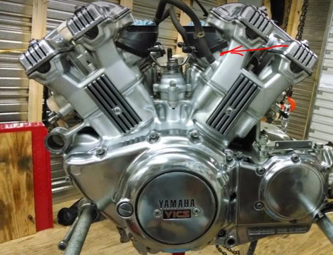

The yics connections not the ones on the rubber carb boots. They are actually on the heads. They may have been capped off.
That is what you're looking for. That's #1 YICS connection. Number 4 is also easy to find. 2 and 3 are a bit harder to get to.
Posted (edited)
Thanks for the great pic and information yamagrl!

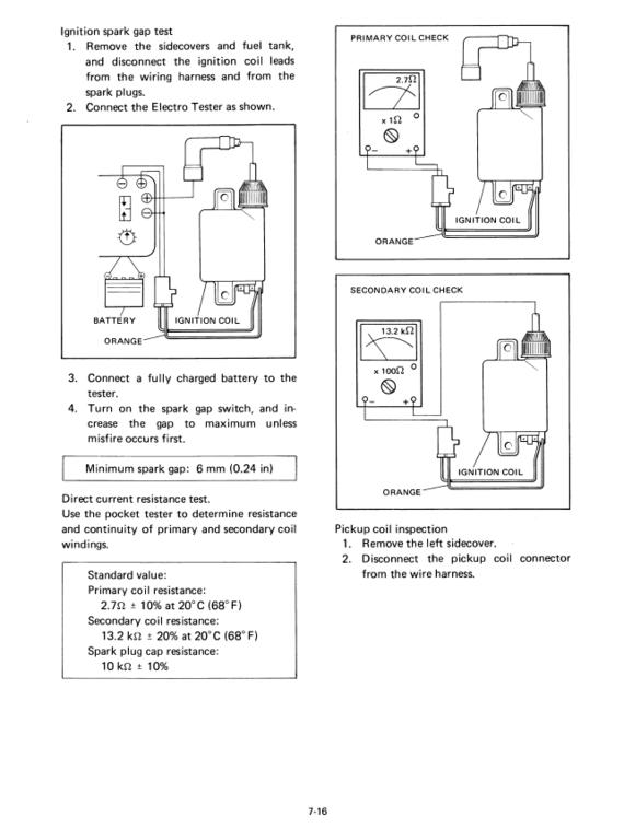

What are the coil and wire supposed to ohm out? All four had what looked to be strong spark but I'd feel better once I measure the coil/wire resistance.

What are the coil and wire supposed to ohm out? All four had what looked to be strong spark but I'd fell better once I measure the coil/wire resistance.
Page 7-16 in 83-85 manual
