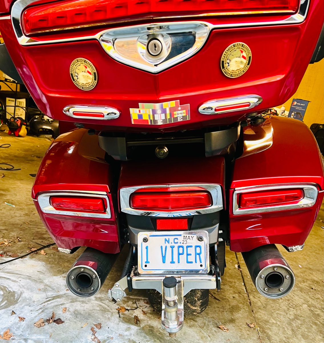

ChiefGunner Posted January 1, 2023 Posted January 1, 2023 Well, after all the customization I couldn’t resist the “final touch” of a custom vanity plate. I had some ideas that apparently others had taken before me, but I ended up settling on “1 VIPER”. DMV says about 7-10 days to get it. 2
ChiefGunner Posted January 7, 2023 Posted January 7, 2023 I’m loving it. Everybody names their ride, and mine is called “CrimsonViper”. So, I had custom emblems made out of 316 stainless polished to chrome mirror finish. They finally arrived today! 4

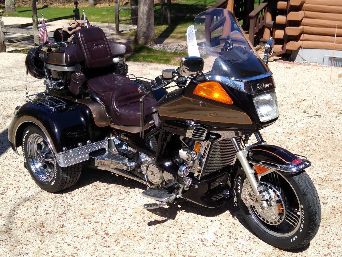

bikenut Posted March 28, 2023 Posted March 28, 2023 Just got done changing oil/filter on my 1986 Yamaha venture royal Trike. Also put a new tire on the front and bled front brake. Going to be riding again after getting two new knees last year. All that is left is to polish her up nice and shiny. Enjoy your day 4

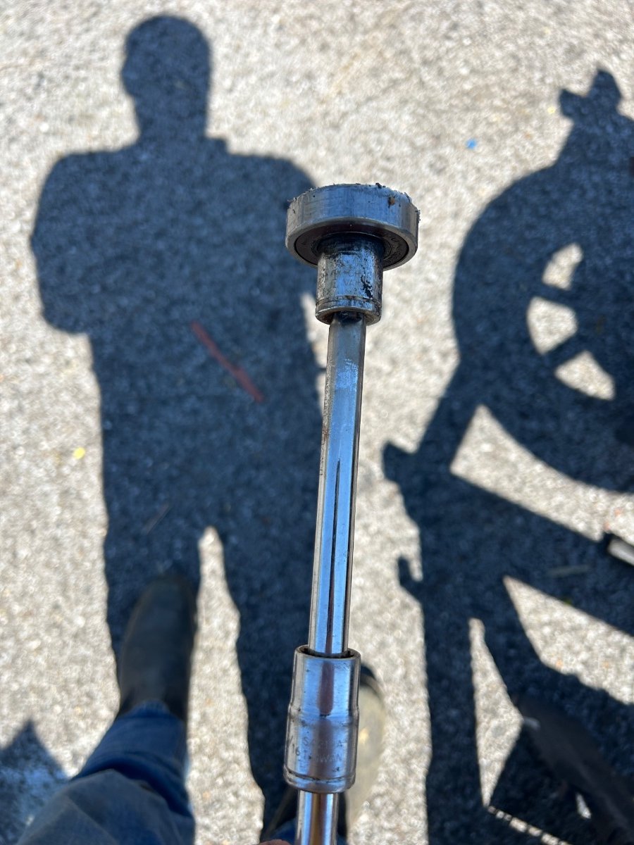

RDawson Posted March 29, 2023 Posted March 29, 2023 Starting to feel like riding some more and needed a new front tire, got that installed today and finally replaced the front wheel bearings after having them on the shop wall a couple years. Figured out I didn’t have a drift long enough to get em out so I welded a sacrificial socket to the inner race and used a long extension and hammer it out.
Marcarl Posted March 30, 2023 Posted March 30, 2023 On 3/29/2023 at 11:16 PM, RDawson said: Starting to feel like riding some more and needed a new front tire, got that installed today and finally replaced the front wheel bearings after having them on the shop wall a couple years. Figured out I didn’t have a drift long enough to get em out so I welded a sacrificial socket to the inner race and used a long extension and hammer it out. Expand Good idea. Got any more sockets? Is that a 10mm?
