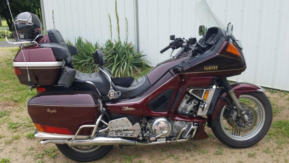

gggGary Posted August 12, 2020 Author #1007 Posted August 12, 2020 Got this from a widder lady, the shortest easiest wake up drill EVER. Now have about 2K miles on including a great camping trip to the UP, biggest upgrades, work; LED headlight, removed radio to make room for a "glove box", resoldered air suspension controller board, RAM mount for 396 Garmin. new tires 777HD rear, random Shinko rear I had on the front. Got rid of the big floor boards on the crash bars put on on smaller pegs that won't dig in on corners, cleaning grime from underside. new windshield, Spent more time digging wax residue out of emblem crevices than anything else.

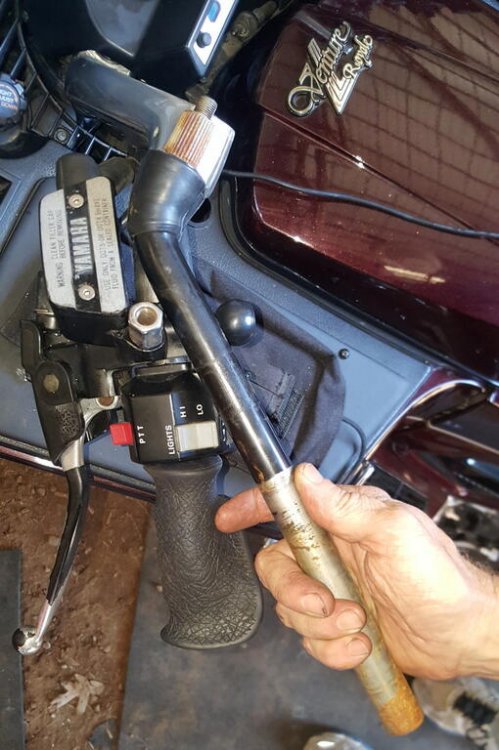

gggGary Posted August 25, 2020 Author #1019 Posted August 25, 2020 (edited) This A generous member donated an extra set of bars several years ago, finally got around to using them. Straightened the bend "quite a bit" with oxy-acetylene and shortened them 2 1/2". Took a couple times to get them adjusted where I was happiest but much better now! Also removed the lead weights, so far that's just fine. Grips are Siligrips my favorites! Also snagged a used Barnett clutch conversion and a new gasket off fleabay. She would only slip at hard throttle above 4500 RPM but I do that sometimes. Edited August 25, 2020 by gggGary

bpate4home Posted August 27, 2020 #1022 Posted August 27, 2020 This https://www.venturerider.org/forum/attachment.php?attachmentid=119532 A generous member donated an extra set of bars several years ago, finally got around to using them. Straightened the bend "quite a bit" with oxy-acetylene and shortened them 2 1/2". Took a couple times to get them adjusted where I was happiest but much better now! Also removed the lead weights, so far that's just fine. Grips are Siligrips my favorites! Also snagged a used Barnett clutch conversion and a new gasket off fleabay. She would only slip at hard throttle above 4500 RPM but I do that sometimes. I love the handlebars on the Gen 1s and other Yamahas of the time. Wish they did this for the 2018.

cowpuc Posted August 28, 2020 #1025 Posted August 28, 2020 I love the handlebars on the Gen 1s and other Yamahas of the time. Wish they did this for the 2018. :sign yeah that::sign yeah that: You and me both @bpate4home,, you and me both!! As a matter of fact,, pure simple flat out fact,, I love them so much that when Freebird put out the call years ago for us club members to come up with our wish list for the new Venture (found here - https://www.venturerider.org/forum/showthread.php?102280-Let-the-discussion-begin&highlight=1700cc+v-max ) way back while the new model of the Venture was still on the drawing board,, those bars of which you and I speak were on my wish list of what I thought would add to the possibility of the new Venture actually turning the touring bike world upside down (as Mom Yam said its final product was going to).. Funny thing is,, if you read thru my list below copy/pasted from the actual thread above, you will probably come to the same conclusion that I did when I first saw the new bike at the world release of it out at Lake George, NY.. That being that Mom Yam actually did read our input and did everything in her power to come out with a bike with everything opposite of that which our clubbers had wished for .. At any rate,, here is my list from a time long ago: 1700cc V-4 "V-Max" motor.. Detune it if you must (just like before) but please,, dont do another V-Twin - got enough of em.. You guys can do it,, I KNOW YOU CAN!! Shaft drive! EFI with a tunable tuner - even if its an add on - please provide one so we can tune it!! LED lighting. Engine guarding and saddle bag guarding. Adjustable bars like on the first gen. Factory tank and windshield bags. Fixed Fairing. Get the same Doctors who advised you on constructing the seat of the 1st Gens (cant remember what you call those guys) to advise you on this one - my kids, wife and I LOVE what they did!! Keep the seat height difference between the rider and passenger no more than 3 inches (2 is great) - raising the passenger higher causes weight imbalance and makes slow speed riding harder. Ease of removal of the trunk(s) for changing rear tire. Center stand. Forward boards with normal foot pegs located rearward so standing up while riding is still possible, shift and brake levers at both locations (no heal toe please). Hand warmers. Key removable rear trunk and bags. Grease zerks on all main pivot points. High output stator even though it has LED's. Double check the gear sets in the tranny and make sure they ramp up solidly. Oversized clutch to insure NO slippage in high gears with xtra weight. 42 millimeter front fork tubes with progressive springs. Imbed reflective tape (or use reflective paint) in paint lines (like pin striping) so all profiles of bike light up when grazed by car lights. Add a large foot onto side stand - tired of bending over to pick up stand plate after parking on loose ground. Explore which tire sizes are the most common and build around those standards so tire choices and finding them are easy. Remember those long grips you used on the first gens? Use those, I love bending them back onto my knees. Enclose the motor well to keep ANY objectional heat off both riders BUT - use lots of venting with plenums to act as heaters when needed. Windshield it so the rear rider remains in the protective air pocket - functional vents in shield and fairing to adjust air movement if needed (hey,, could be asking for servo operated shield but I dont care for more things to go wrong). 6 speed Over drive tranny. Use GOOD solder, especially with ECU pins. QC the daylights out of it! DONT go cheap and trust the Chinese!! Dont short us on wire harness leads so wiring is tight - xtra 1/4 inch really helps!! Make fairing panels easy to remove but not so they fall off. Supply printable shop manual disc and printed well written owners manual. Supply GOOD factory tire pressure guage. Chrome is out for me, I LOVE dull stainless (like the pipes on the "New" V-Max),, matter of fact,, build mine with no rustable chrome and all dull stainless!! Intercom, CB and radio would be nice.. Keep the tape deck.
