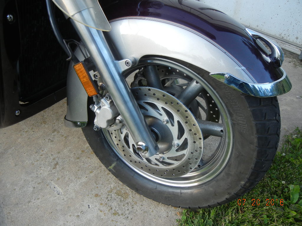

gggGary Posted July 21, 2016 Author Share #29 Posted July 21, 2016 Got the front wheel polished and all back together. Did a test ride, 80 miles isn't enough, but dark and deer is no country for old men. Kinda pretty along the Wisconsin River. Link to comment Share on other sites More sharing options...

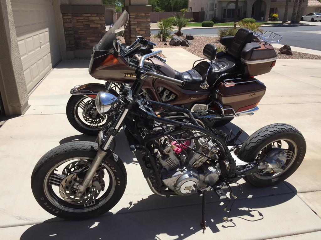

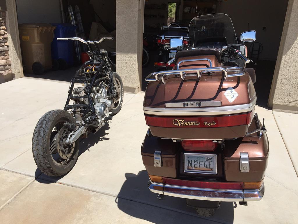

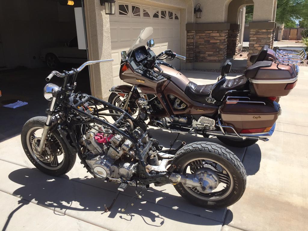

VanRiver Posted July 24, 2016 Share #41 Posted July 24, 2016 Today I was trying to remove an engine from a donor bike so I can rebuild and upgrade it with V-max parts to be installed in my Brown 86 Venture Royal. Was sweated my butt off again in the Garage at 112 degrees F....but still very enjoyable...turning wrenches is relaxing for me and a good workout in the heat! Here is what a Naked 86 venture looks like next to a fully dressed 86. (Viewer Discretion is advised - contains Motorcycle nudity ) Hard to believe they are the same bike (except for the aftermarket Bars and Headlight the previous owner put on it of course) Link to comment Share on other sites More sharing options...

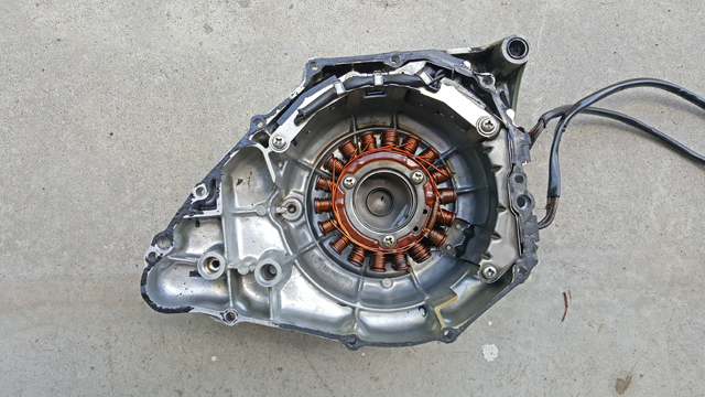

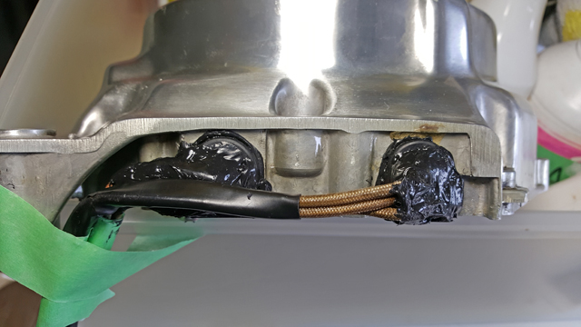

Max Posted July 24, 2016 Share #48 Posted July 24, 2016 Cleaning stator wires, rubber grommets, removing old gaskets off stator & gear covers with Permatex and RTV'g wires. What a fun week end. It's not pretty, but certainly hope it cures 'the drip'. Should have r' back on the road in a couple of days. Link to comment Share on other sites More sharing options...
Dragonslayer Posted July 24, 2016 Share #49 Posted July 24, 2016 Cleaning stator wires, rubber grommets, removing old gaskets off stator & gear covers with Permatex and RTV'g wires. What a fun week end. It's not pretty, but certainly hope it cures 'the drip'. Should have r' back on the road in a couple of days. [ATTACH=CONFIG]106456[/ATTACH] [ATTACH=CONFIG]106457[/ATTACH] I've had the same problem and got to stop be sliding the grommets out and putting a fine layer of silicone along the edge groove of the grommets before sliding them back into place. Link to comment Share on other sites More sharing options...
