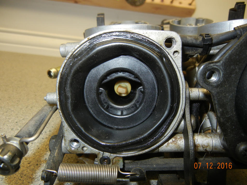

gggGary Posted July 17, 2016 Author #2 Posted July 17, 2016 (edited) breathless update: I opened clutch reservoir and poked into second port with a sharp pick. The second hole is VERY small and easily clogged. Took it back out and almost no slip even under hard throttle up a steep hill. Need to go run up another hundred miles see if it goes back to slipping. But hey I am willing to do that in the name of science! :wink: OK a guy can hope, right? Bike had been in a cycle shop for "make the damn thing run so I can sell it" work, clutch was "bled", front master cylinder was "lubed". Invoice included two cans of DOT 3, I can only imagine. This was his work also... Edited July 17, 2016 by gggGary fat fingers
