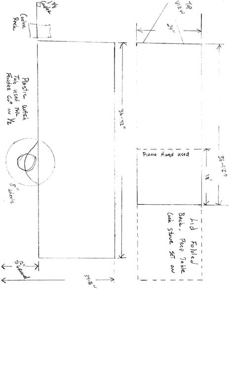

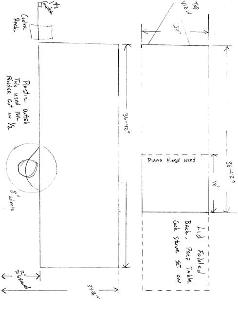

djh3 Posted July 9, 2016 #16 Posted July 9, 2016 If I can get a chance tomorrow or next day I will see if I can draw up a sketch of how my trailer was done. A friend built it himself for tent camping which we did also back then. Wife sort of requires indoor plumbing now. It was a bit taller than wide and was made so when you flip lid open it would double as work, prep space. Can you get aluminum welded? Or you convinced you want to go with the old frame?

djh3 Posted July 10, 2016 #22 Posted July 10, 2016 OK So Rob sent you a pm with some info. Best I can recolect this is purdy much what I had.
Rob Swallows Posted July 11, 2016 Author #23 Posted July 11, 2016 Thanks a bunch. Pretty much on the same path as I with exception of I want to use a torsion axle rather than a slipper spring setup. My box will measure a bit larger than yours also but will be adjusted with the suspension to give a good balance of height, and running profile. I may even make the suspension adjustable for tongue weight with pins and polymer pads. It will be used much more often if easy to load and have easy access to the contents. I should know more tomorrow when I speak with the vendor about suspension of which way to go. Thanks, Rob
djh3 Posted July 11, 2016 #24 Posted July 11, 2016 Yea mine served well for what it was. Heck we even pulled it behind a Firebird we had for awhile. It was a fair design for what it was a trailer to put camp gear and clothes in. Knowing what I do now I would probably make it wider and lower, even if you had to make the lid opening bigger, you could make a pole to go under the lid when layed back to support it for a stove or what have you.
