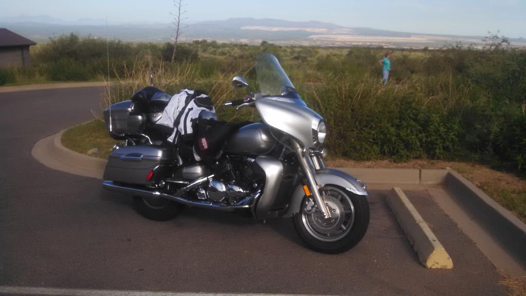

videoarizona Posted July 2, 2016 #5 Posted July 2, 2016 (edited) OK, on a second gen, one horn is in left side of fairing, second is on right side next to the passenger foot rest. I bought a mount from one of our member vendors and mounted my Stebel behind the passenger foot rest... Wired in tandem with fairing mounted stock horn through a relay. Works like a charm. On the picture, you can see original stock horn I left on bike(not plugged in) just in front of rear exhaust pipe behind trannie cover, and the Stebel behind the same exhaust pipe, behind the passenger foot rest. Edited July 2, 2016 by videoarizona
