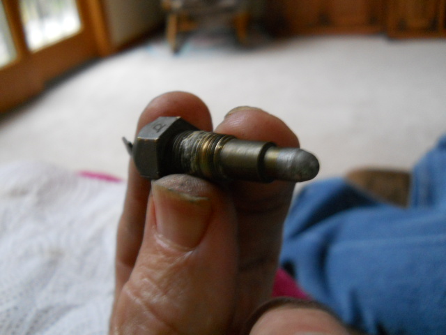

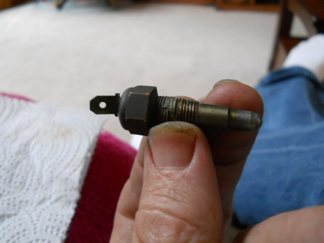

cowpuc Posted July 1, 2016 Posted July 1, 2016 I am thinking it will work.. Fozzie, on the 83's - the temp sending unit is the first sending unit you would see if you were standing on the right side of the scoot and looking at the sending units - the second one is the fan control.. Does this sound familiar to you? Gonna go pull the sending unit - take a quick snap shot and post it here before I find a little box to send the sender to you:sun1:...
cowpuc Posted July 1, 2016 Posted July 1, 2016 This look like what your after @DragonRider? This is the temp sender for an 83... PM me an address if it is and I will stick her in the mail brother!

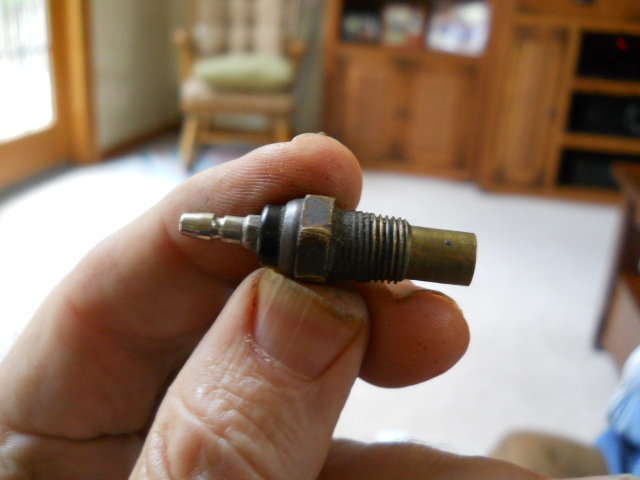

cowpuc Posted July 1, 2016 Posted July 1, 2016 No Foz,, Cimmer is correct and I screwed up - the smaller of the two - the one with the single pin connector (one on the left that you have circled in the picture) IS the temp sending unit. The blade terminal one that I had taken a pic of is a single blade fan switch for an 83 - the one on the right in your pic that has two blade terminals is your fan switch. This makes sense because if you check a parts fiche for the two bikes it does show different part numbers for the Fan Switch (different Prefix before the part number) and I bet cha yours having two blade connectors and mine only having one is the reason why.. THE TEMP SENDING UNIT IS THE SAME NUMBER SO THE UNIT I HAVE IN MY HAND SHOULD WORK FINE - SEE PIC. PM me your address Lewis and I will stick it in the mail for you..
