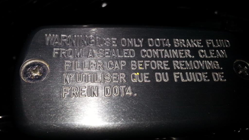

Rob Swallows Posted June 29, 2016 Author #10 Posted June 29, 2016 Please use DOT 4 Brake fluid... not 3. Please clarify the preference. I've never used DOT 4 and have never had problems with DOT 3. Not being smart azz, just don't know the difference. Thanks, Rob

Flyinfool Posted June 29, 2016 #13 Posted June 29, 2016 Please clarify the preference. I've never used DOT 4 and have never had problems with DOT 3. Not being smart azz, just don't know the difference. Thanks, Rob DOT 4 has a higher boiling point when fresh out of the bottle. Dot 4 also absorbs water faster than DOT 3 and the water will cause either to have a lower boiling point. It does not take long for the DOT 4 boiling point to drop below the boiling point of DOT 3. So IF you are super religious about changing your brake and clutch fluid very regularly then DOT 4 may be a better choice. IF you wait a few years between changes then DOT 3 is probably a better choice. The listed boiling points for DOT 3 and 4 are MINIMUMs, there are DOT 3 fluids with higher boiling points than some DOT 4 fluids.
Du-Rron Posted June 29, 2016 #14 Posted June 29, 2016 Please clarify the preference. I've never used DOT 4 and have never had problems with DOT 3. Not being smart azz, just don't know the difference. Thanks, Rob DOT4 has better heat handling ability, is recommended by Yamaha, and just plain tastes better! Check out why your clutch fluid is darker on page 2 of the following thread by the Yamaha bulliten enclosed. http://www.venturerider.org/forum/showthread.php?97279-Baking-Clutch-Fluid-Exhaust-Heat-Shield Ignore the DOT3 usage in the bulliten as it was an old bulliten explaining clutch fluid color. DOT4 has supersceded 3.
BlueSky Posted June 29, 2016 #15 Posted June 29, 2016 The highest point in Yellowstone Park is about 11k ft. above sea level which lowers the boiling point of any fluid. With riding in the hills and using the brakes more often adding heat, there could be a little more risk of DOT 3 boiling. My wife and I are discussing going to Yellowstone this summer (in a cage unfortunately) and I checked the average temps last night. In July, the average day time high is 72 and low is 40. So, it never gets very warm at that elevation.

Rob Swallows Posted June 29, 2016 Author #17 Posted June 29, 2016 I don't mind the routine of changing out brake fluid at all. Years ago when it was cheap to rebuild wheel cylinders brake fluid was like rear end lubricant being assumed to last the life of the vehicle. I know better now with some age behind me. I do like the added boiling point of the DOT 4 fluid so very well may go with it as I'll be pulling the trailer w/cargo. I know September still is pretty warm around parts of the country and the added "cushion" or safety factor of the later fluid shouldn't be negated. I always run "low silicate" formulation and distilled water in the coolant and am switching all my lubrication fluids on the trucks to synthetic. The bike can go the same route. My bike has aftermarket "Star" chromed reservoir covers without writing. I've got to download the service manual on the site here for reference soon to clear up some brewing questions. Really appreciate you guy's insight. I'll post up my itinerary once finalized and maybe we can meet up along the way. I don't drink except coffee and water so a small family type restaurant works great for us. Thanks to all. Rob
