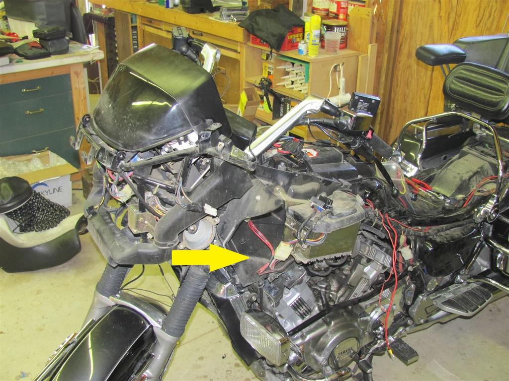

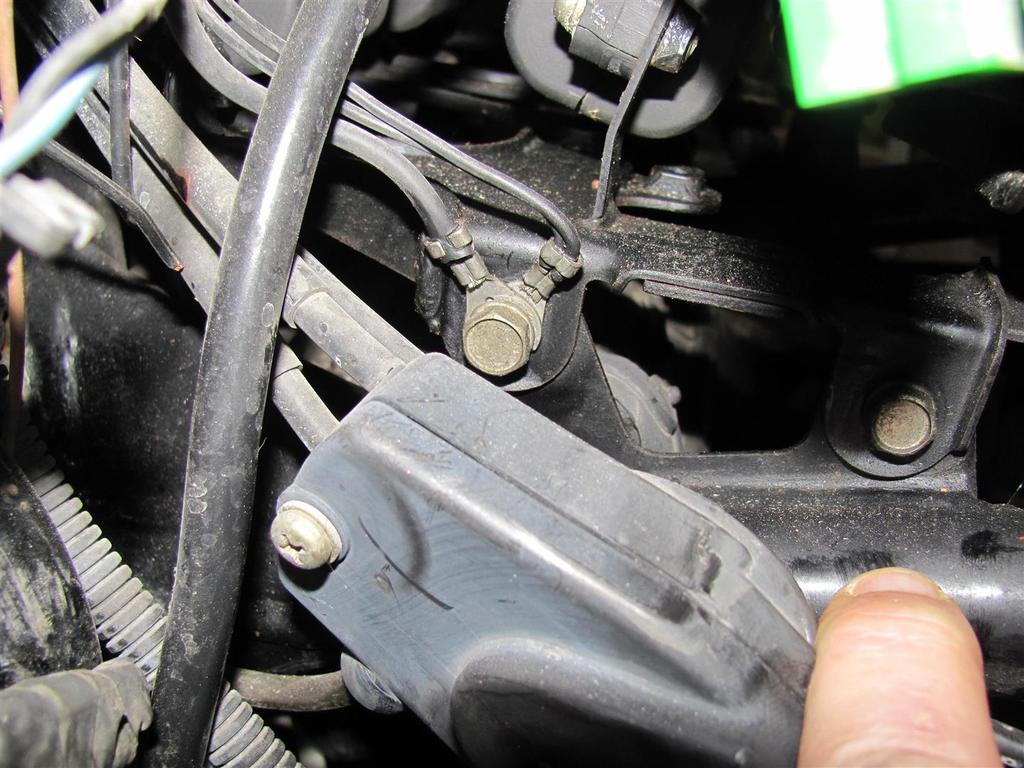

Unfortunately, no matter which of the throttle cables have broken, you will have to remove the left main fairing and the left inner fairing to access the "five into one" junction box. To change ANY of the five cables that junction will have to be accessed and disassembled. My finger is on the junction.

The junction is located at the yellow arrow in this pic, behind the inner fairing panel.
