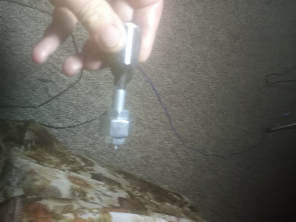

SAP71 Posted March 9, 2021 Share #12 Posted March 9, 2021 Here's the version I came up with. 5/8" hex nut (fits 15/16 socket) locked between two 10mm hex nuts on a 10mm hex bolt (fit 17mm socket). I taped it to the socket so I could pull it out of the fork tubes when I used it to hold the dapmners. I didn't have a helper or a lot of extensions so I used bungee cords in the caliper mount holes to keep the forks compressed and zip tied the ratchet to the triple tree. It worked great. Plus no welding required. Link to comment Share on other sites More sharing options...
saddlebum Posted March 9, 2021 Share #13 Posted March 9, 2021 I just ran a nut the right size to fit the the hex hole in the cap nut ran it on to a bolt tight up against the head of the bolt. then cut the protruding end of the bolt off leaving a 1/16th" of the bolt sticking out past the nut. Finally I pounded that protruding bit flat with a hammer (a ball peen hammer works best if you have one) so the nut could not back off, then simple used it with a socket wrench to remove the cap nut. Cost $0 since they came from my junk box of nuts and bolts. Link to comment Share on other sites More sharing options...
