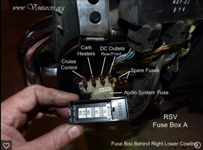

Hoping someone will be able to troubleshoot an electrical issue I have while we're at Don's MD. My outlet under the left inside of the fairing is not working, so I can't use the GPS....in fact, without it I may not even find my way to Don's!!:confused24::confused24:
Yup Reiny, one of us will get 'er done! I have a short project with Leo3wheel that will take me about a half hour to an hour but after that I'm free. As mentioned, there is a fuse for that outlet on the fuse block that is located inside the front lower cowl, the right one I think. It is not the fuse block that is behind the false battery cover. Also that plug is only on with ignition I think...

Reiny, Yes, bet it is the fuse. Blew mine in Arkansas with my air pump and lost use of my GPS. Opened the right cowling and replaced the 5A fuse with
a spare provided.

OK...seems leo3wheel wins the prize! It was nothing more then a blown fuse. Thanks to XV1100SE for the assistance tonight. Got her all fixed up, cleaned up and tomorrow she'll be gassed up....c'mon Friday.
