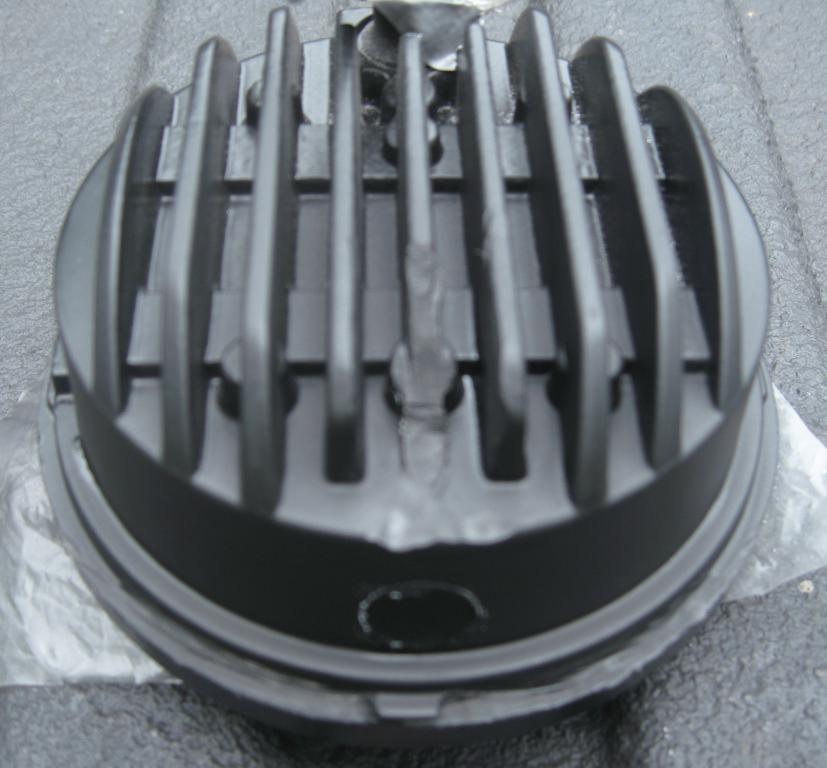

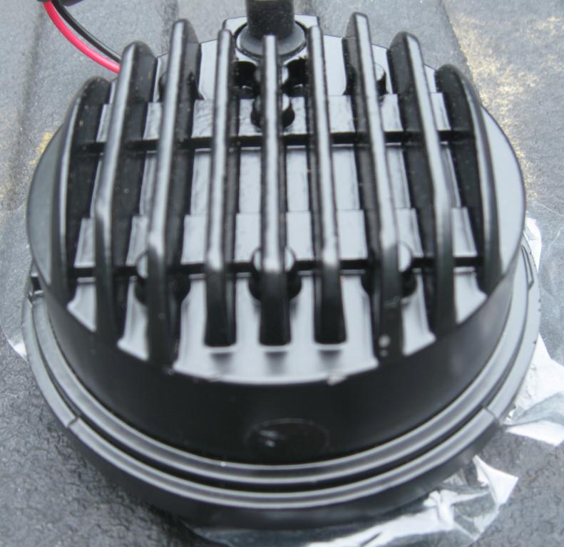

I found out that the back of the light needs to be modified or find a smaller hollow bolt. I went with he modification, the center rid needs to be trimmed back in order to use the stock hollow bolt:

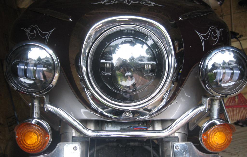

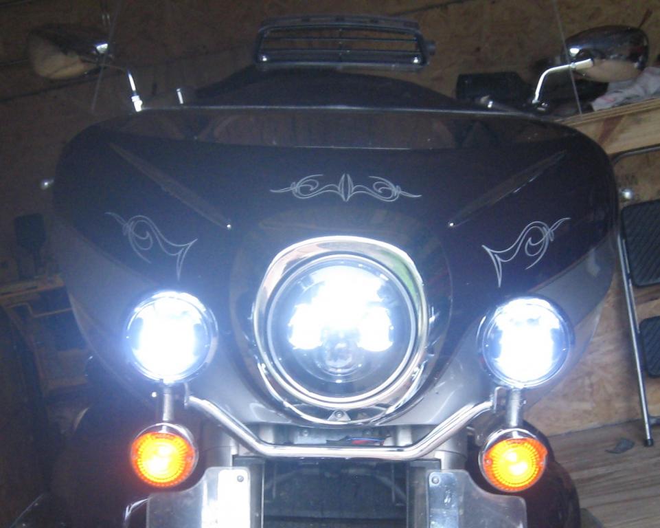

Old and new passing light installed:

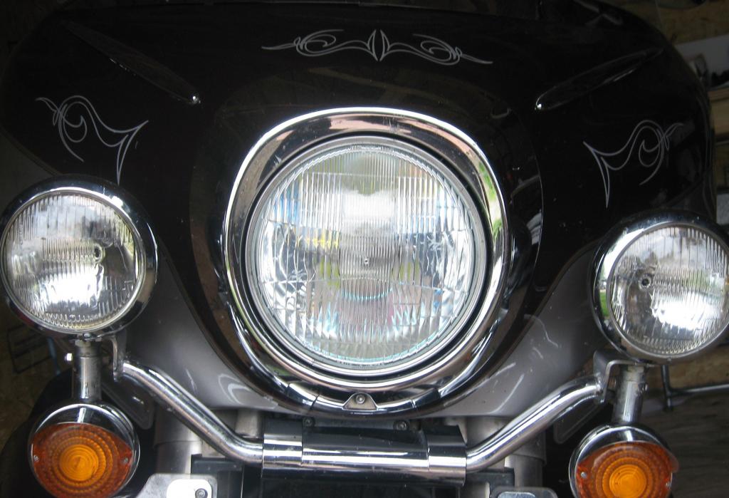

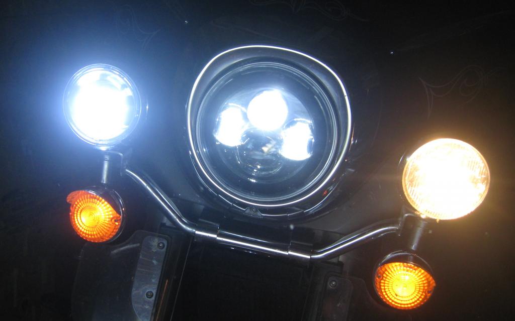

Lights on side by side look:

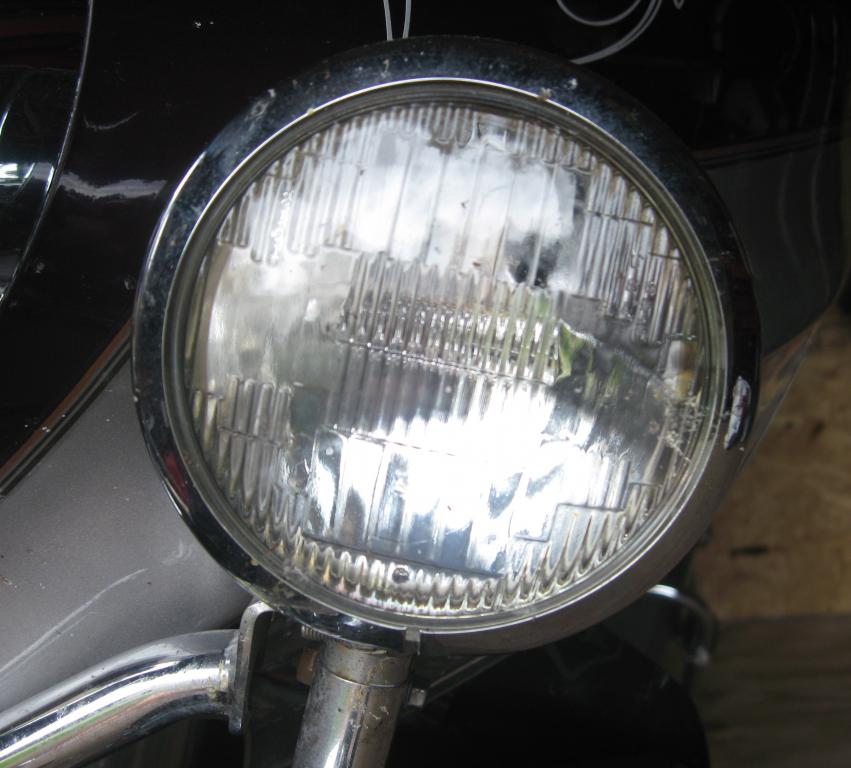

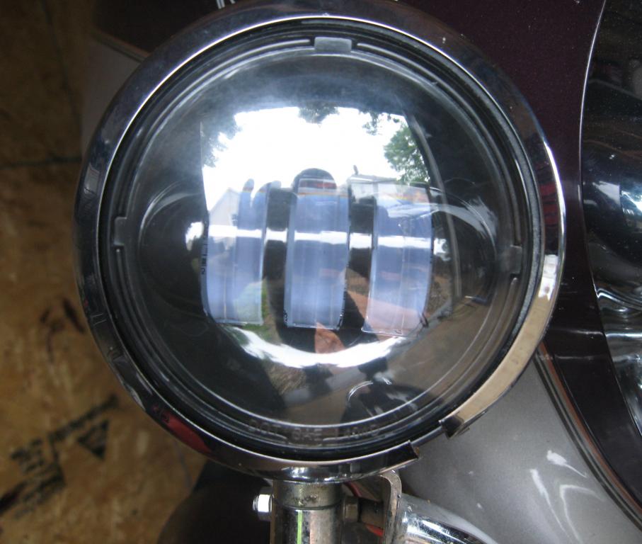

Old passing light look:
New passing light look:
All new just need to adjust the lights tonight:

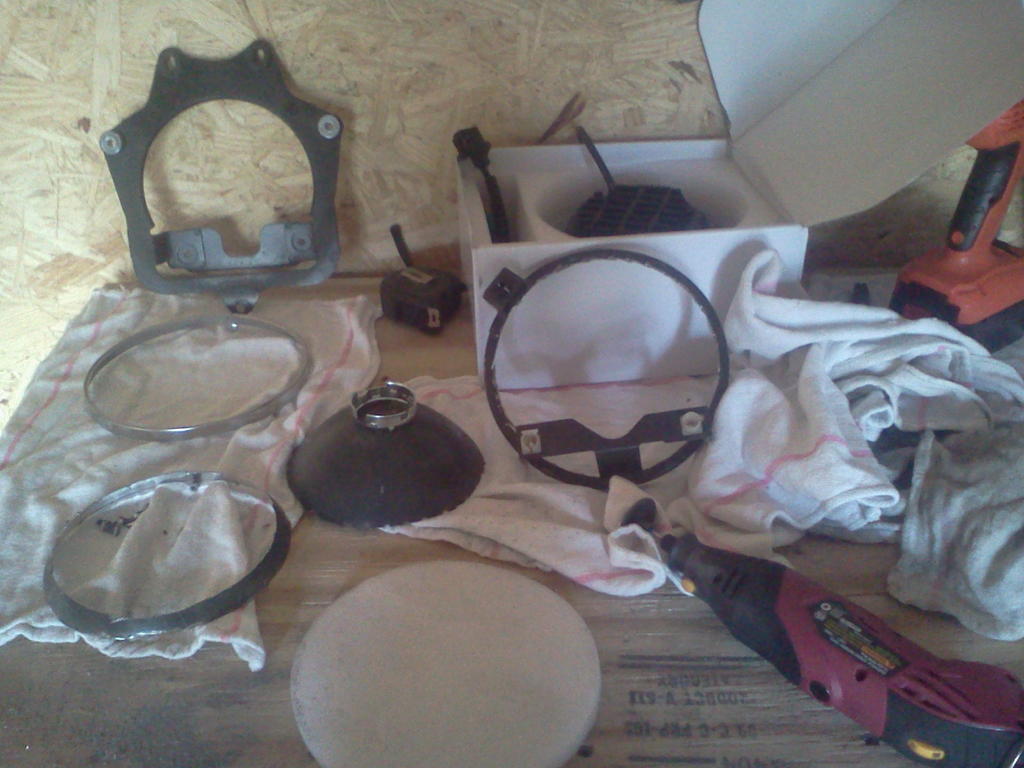

I tried something that did not work. Than I found this website:http://venture.eurekaboy.com/headlightmod.htm I purchased a used headlamp off ebay and used that one to cut. I took my time did not want to rush and spent a complete weekend. The hardest part is trimming both the buckets and the back of the headlamps and passing lamps.
