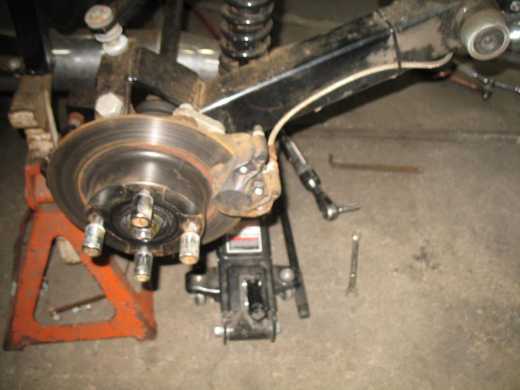

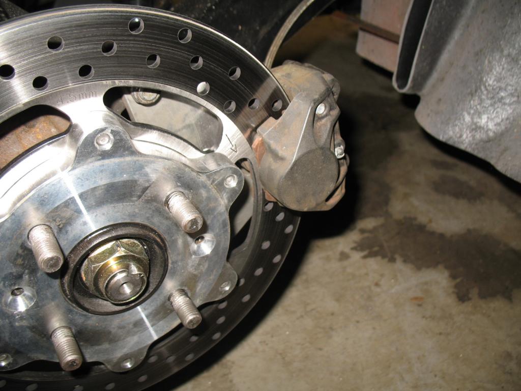

FA-266HH is what I have for the new style . Does the trike Have brakes that look like this ?
[ATTACH=CONFIG]105687[/ATTACH]
New style
Or like this
[ATTACH=CONFIG]105689[/ATTACH]
Old style
Read http://www.venturerider.org/forum/showthread.php?67621-Hannigan-Brake-Pads-(Part-Number)&highlight=brakes
His is the new style. Tried to find pads today with no luck The last thing we were told what the FA 266HH was the corrent ones but no dealer in the area has them so...Ordered a set and will have to wait and see.
