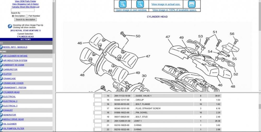

Du-Rron Posted June 1, 2016 Posted June 1, 2016 (edited) Shown as #20 here for a 2012 RSV is the same part and they look kinda the same. Bet they are. Shows availability at my dealer (any Yamaha dealer) for $26.00 Edited June 1, 2016 by Du-Rron

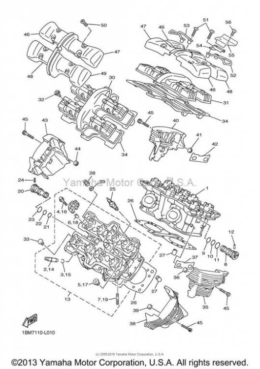

mabeline Posted March 7, 2022 Posted March 7, 2022 I know this is an older post. I've got a 2008 RSV with 100 k miles I've got on of these plugs leaking pretty good. I tried the dime behind the cover,( as mentioned along time ago on here) and it worked very well for a lot of years. I'm wondering if I could change out the O-rings to fix the problem ( Prt #s 21-23 ) Any thoughts? Thanks in advance!
cimmer Posted March 8, 2022 Posted March 8, 2022 Looking at this, I think I would get the o-rings, 21,22,23 and maybe the Spring pin, 24 and replace those parts as they are not included if you just got the Joint, #20. You might as well get enough to do both joints since you will have the coolant out of the engine. So yes I would start with replacing the 0-rings on both and clean the joints up and where they are inserted at also. Good luck, Rick F
mabeline Posted March 8, 2022 Posted March 8, 2022 Hi Rick Thanks for the reply. I guess I should have deleted my post, because I goofed! I noticed this was 1 Gen tech section after I posted. Looking at the Parts Fis (sp) I thought this was what I needed. After a second look, I need the rubber plug that's lower on the water jacket. They're pretty cheap to get. Thanks
