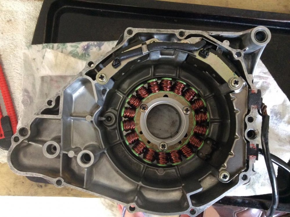

Kiwiroyale Posted May 22, 2016 #4 Posted May 22, 2016 G'day Nate, IMHO I would never re-use a gasket. Now Unfortunatley there is really only one way to fix it properly... Yeaup you guessed it!! What I would do is clean around the cover whilst it is on the side stand, (or position you notice leak) take special notice where the leak is coming from, you may have to warm her up first to get her "leaking", my guess is that it will actually be where the "wire plugs" exit the case, this is where I had a small leak on my '83 prior to replacing the stator. I spent more time preparing the "mating surfaces " than it took me to replace the stator, the photo I posted in your original post shows just how clean I got them. As you will now know the rubber plugs (two ) have a small "ridge" that mates into the cover, THIS RECESS MUST BE CLEAN AND FREE FROM GASKET GUNK, i used a very small amount of gasket gunk (call it what you will) on these plugs as I inserted them into the cover (see slight red colour on the photo). NOW what I found was the "plugs" would push in slightly "deep" into the cover leaving a "gap" that the new gasket could not "fill" the result would have been another leak.ENSURE THAT THE RUBBER "plugs" are level with or slightly "proud" (100ths) of the cover so that the gasket can "fill the gap". Alternately the plugs would sit "too proud" as a result of gunk in the recess, same result the gasket cannot "fill" the small gap left at the plug. I hope this makes sense and I have not stated the obvious to you mate. steve
