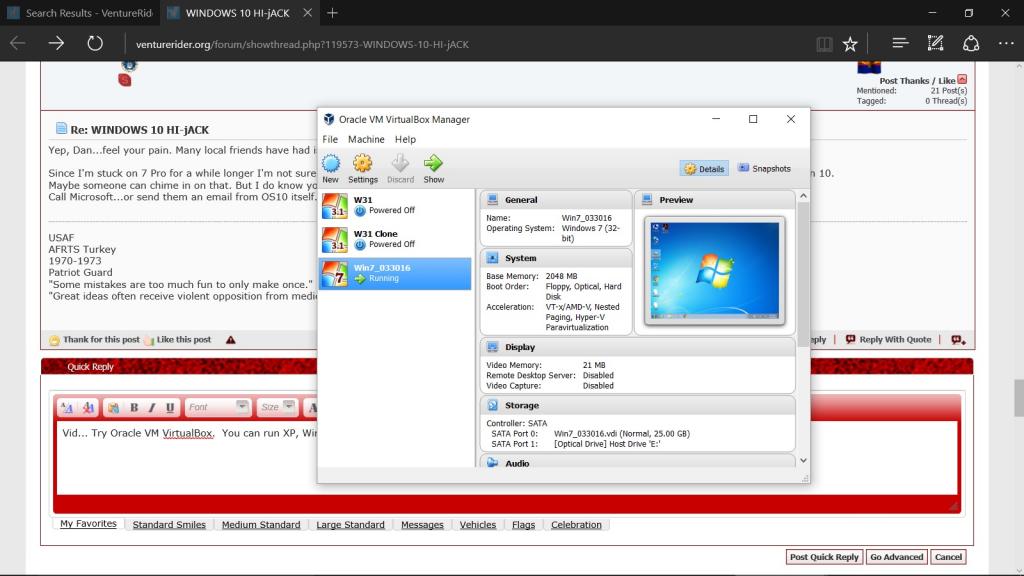

Du-Rron Posted May 19, 2016 Share #33 Posted May 19, 2016 Vid... Try Oracle VM VirtualBox. You can run XP, Windows7, or even DOS if you want, in a Window, under Windows10. Link to comment Share on other sites More sharing options...

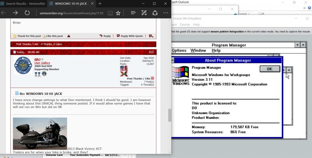

djh3 Posted May 21, 2016 Share #37 Posted May 21, 2016 I have since change settings to what Don mentioned. I think I should be good. I am however thinking about this ORACAL thing someone posted. If it would allow some games I have that will not run on Win but did on 98 Link to comment Share on other sites More sharing options...
Du-Rron Posted May 21, 2016 Share #38 Posted May 21, 2016 I have since change settings to what Don mentioned. I think I should be good. I am however thinking about this ORACAL thing someone posted. If it would allow some games I have that will not run on Win but did on 98 Oh yeah... Oracle VirtualBox. Google it. You will like it. Running Windows 3.1 For Workgroups below. Link to comment Share on other sites More sharing options...
djh3 Posted May 21, 2016 Share #39 Posted May 21, 2016 So is thing easy enough a Cave Man can install and run I E Puc or me? Link to comment Share on other sites More sharing options...
Du-Rron Posted May 21, 2016 Share #40 Posted May 21, 2016 Go to Oracle and do some reading. The first step is always the hardest. The stronger and more memory your host system has the better your virtual machines will work. For instance, without degrading my host at all, I allocated 1gb memory and 32gb harddrive to Windows3.1 guest. This is the fastest Windows 3.1 you have ever seen run. Period. Running Windows 7-32 bit guest I gave it 2gb memory and 150gb harddrive and turned on hardware VX. It runs just as fast as the host setup. I wouldn't try doing this with less than an Intel 5 series or AMD A6 computer with twice the memory available you want to dedicate to your guest operating systems and in no event less than 6gb memory total on the 64-bit host. Link to comment Share on other sites More sharing options...
