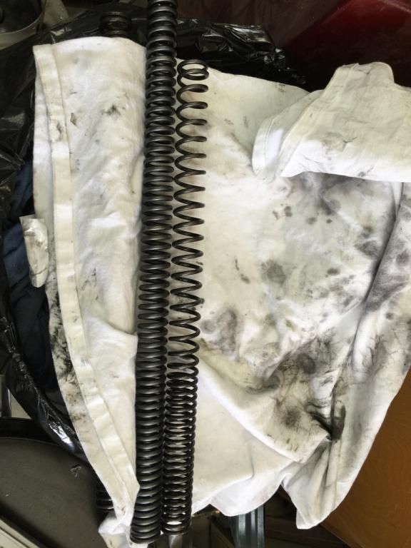

I replaced the old worn out stock Fork springs today on my Dad's 1986 Venture Royale. Changed them out for a new set of Progressives from "Progressive Suspension" (Ebay purchase for $76 USD...not too shabby).
No wonder the old girl was riding pretty low in the front.....those stock springs are pretty thin for a 800+ scoot like the Venture compared to the new "heavy Duty" progressives. (Picture: Yamaha Stock OEM on the RIGHT.....New Progressive on the LEFT).
With new Springs, Seals, and Fork oil that should take some of the bumps out of our Canadian roads!:7_6_3[1]:

By the way,,, its said that a picture is worth a thousand words,,,, that :photographing: of those springs pretty much prove that saying to be correct brother!!:missingtooth:

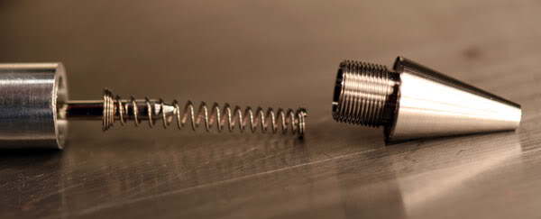

Thanks @cowpuc! You are correct, I got the same spring in my clicky clicky pen! Maybe Mom Yam was in partnership with the Bic Pen Corporation back in 86? :hurts:

Interestingly....they are not, at least not how I expected....one end IS wound a tad bit tighter....but not nearly as "progressive" as I'd thought they would be.
Looks like you could put a fairly long spacer on top of the stock springs to stiffen things up a bit if you are a cheapskate like me? Just looking at those Progressive springs me thinks they might be too stiff.
Worn out springs are worn out springs period! You can "tune" the Progressive or any brand spring to be softer or stiffer by the thickness of the spacer. When the spring rate goes bad on any spring it looses it's spring action somewhat.
You state you think the Progressives might be too stiff, and you want to try spacers to make your worn out springs stiffer?? There are other brands of springs you could buy that may not be as stiff (to me effective is a better word)...

The progressives may look like they are to stiff, but there are many many of us that have put them in and I can not recall anyone saying they were to stiff.
The progressives are progressively wound. Progressive means that the coil spacing is tighter on one end than the other and the pitch changes progressively from one end to the other, as in no two coils have the same pitch.
The OEM springs are 2 stage, one end is wound tight then makes a sudden chance to a looser wind, so there are only 2 spring rates.
Back when our scoots were built, CNC winders to do progressive were just being invented.
From the photo, there is a huge difference in the two springs. Seems like there would be a huge difference in the spring rate too. Yeah, if I look closely, I can see that the "Progressive" spring is indeed a little progressive. I suppose Yamaha intended for the air compression to add to the overall spring rate and maybe make the ride a little more velvety feeling. The air pressure could also have the effect of reducing fork oil foaming. I'm just learning about these bikes and I appreciate all the rider knowledge that goes into all of the posts.
