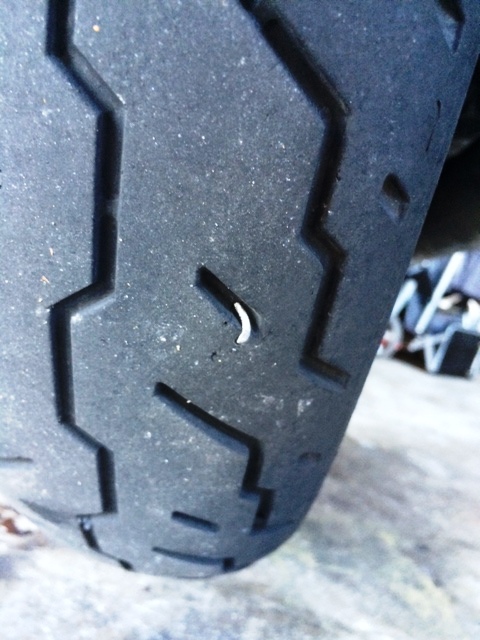

KIC Posted May 13, 2016 Author Posted May 13, 2016 Well I found the culprit. After checking the bike out pretty thoroughly over the last week. Including a 150 mile ride last Saturday, The bike was running very well. I checked the tire pressures Tuesday night and rode it to work on Wednesday. A little more tinkering and a good washing on Wednesday night and decided NOT to ride it to work on Thursday so everything was ready for our Friday AM departure. I guess on Wednesday I picked up this little hitchhiker. This little nail is going to cost me over $300.00 including a new tire, lost hotel reservations not including my wife and I both took a day off from work. It had 18 lbs of air in it, so when I got off the bike and looked at it it looked OK, but with both of us on it, obviously flat.
Flyinfool Posted May 13, 2016 Posted May 13, 2016 (edited) So does that bring back some confidence since it is really not the bikes fault? A little nail in the center of the tire is not cause for a new tire. Unless it tore a bunch of the belting I would put in a T patch and forget about it. It looks like that tire has a lot of miles left on it. FWIW I put a very powerful N52 magnet on the bottom of my bike to help trip a certain traffic light that I frequent. I don't know how many nails I have pulled off that magnet, I figure everyone of them was looking for my back tire. Edited May 13, 2016 by Flyinfool
Yammer Dan Posted May 13, 2016 Posted May 13, 2016 I wouldn't tell anybody to plug a tire but I've ran them bald with plugs in the middle like that. One of the plugs that fit from the inside would seal it pretty good. Shame ya missed your ride. We gotta meet one of these days..... If I don't plug one tire too many.......
Patmac6075 Posted May 13, 2016 Posted May 13, 2016 For me, personally, I wouldn't plug a motorcycle tire. I'm sure many others have ridden countless miles with no problems, but $200 is a small price to pay and in my opinion it's just not worth the risk....especially if I'm carrying my wife or kids on the back.
MikeWa Posted May 13, 2016 Posted May 13, 2016 If I was going to plug a motorcycle tire I would use a mushroom plug. Once in there is little chance they will come out. Mike
KIC Posted May 14, 2016 Author Posted May 14, 2016 So does that bring back some confidence since it is really not the bikes fault? A little nail in the center of the tire is not cause for a new tire. Unless it tore a bunch of the belting I would put in a T patch and forget about it. It looks like that tire has a lot of miles left on it. FWIW I put a very powerful N52 magnet on the bottom of my bike to help trip a certain traffic light that I frequent. I don't know how many nails I have pulled off that magnet, I figure everyone of them was looking for my back tire. yea...it does. We are really disappointed about missing the ride. But in all honesty it was for the best. You see, I knew I needed brake pads. I didn't think they were bad, just that it was getting time. Turns out that I REALLY needed new pads. The rear were almost totally done and the right front were ready to hit metal. Also, on the right front, it appears that the tiny clip pin on the front rod that holds the brakes in, had somehow become dislodged and the rod was 1/3 to 1/2 way out. This ride was a twisty curvy mountain ride 2-up. The brakes would not have lasted. That little nail was the mustard seed that prevented a mountain of trouble. I now have a new rear tire. new brakes and a little issue with the CLASS that I am sure to be able to clean up. Bitter sweet to miss the ride. Happy that disaster was averted. ( This ride cost me $350.00 to go nowhere)
