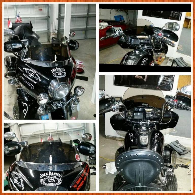

eagleeye Posted May 4, 2016 #14 Posted May 4, 2016 This is the link to a thread, might be it, and this is the pics. http://www.venturerider.org/forum/showthread.php?89584-2nd-Gen-FINALLY-gets-Apes&highlight=paul+yaffe
Condor Posted May 4, 2016 #15 Posted May 4, 2016 (edited) I think those are the ones?? I saved 'm this time... :-) Thanks for finding it.... OK after reading the post I have my doubts. The mod I saw used 10" Krome Werks, no riser. I'd still be interested if someone have a set of OEM's who could put a tape on them for the spread at the neck. Edited May 6, 2016 by Condor
