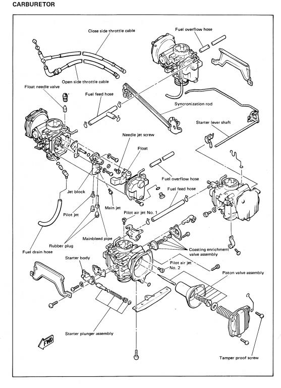

First off there are some gurus on this site that are absolute Karber-Eighter experts and most of the best advice will come from them.
I've read a good bit about the shotgun process Bongobobny mentions. I haven't done it myself but I think I'd try that first.
You can probably get by with the existing jets.
If you need diaphragms get them here http://www.siriusconinc.com/pro-detail.php?pid=&product_id=3988 and use a guitar pick to install them http://www.venturerider.org/forum/showthread.php?106129-Special-tool-for-Sirius-Diaphrams
If you decide to go into the Karbs then I recommend buying Damon Farraiuolo's dvds. They are specifically VMax but the differences are minor and apparent (jet sizes and enrichment linkage I think). His engine reassembly DVD is excellent also. I think they are 20 bucks for both.

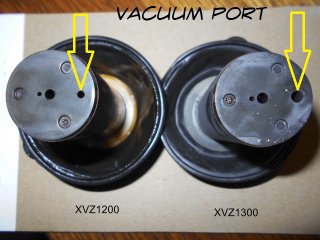

The evolution of the XVZ began with the Mk1 (1200) in 83. In 86 it morphed into the Mk2 (1300), bringing improvements, upgrades. Also in 85 came the Vmax, a high performance 1200.
Most of the occurrences where XVZ12 is not listed is due to upgrades. Many of these items were basically the same but subsequent years were improved design and not original to previous versions. Many of these components can simply be installed, such as the shift segment. However some require additional upgrades such as the Mk2 clutch spring system will work on an Mk1 only if the Mk2 engine side cover over the clutch is changed also. Another example is the front brake calipers. They are paired to the respective lower fork tubes... in order to use Mk2 calipers (or even better R1/R6 calipers) you would have to install Mk2 lower fork tubes. Simple enough, but necessary.
Often it's easy enough to make the determination by simply comparing the parts diagrams. You can also inquire on this forum. Some of these guys have owned the bikes since 83.
The carbs are essentially the same except for some of the jets and the needle valve assy. The Mk1 needle valve assy is different... but I'm certain either could be used as long as the needle and seat is used as a pair.
On a couple of occasions I have ordered a Mk1 part number to just be safe and the Mk2 to part was sent as a superseded part number.

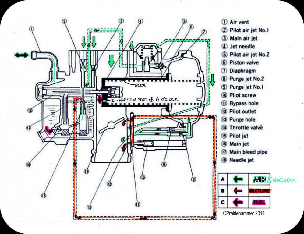

Concerning the "choke" on the 1984: the choke lever on the 1984 is unique to that year Venture. It is "coaxial" with the handlebar, as opposed to the "under slung" choke of the 1983, 1985-1993. I guess it was an attempt to "improve" the enrichener operation, but apparently it was deemed a failure, because Yamaha went back to the under mounted (under the switch housing) enrichener after just one year (1984). Some folks who have complained of the "loose" enrichener lever on the 1984 have wrapped some friction tape (as a string) around the hand grip, between the hand grip and the choke lever, to tighten up the choke action.
Concerning the difficulty in starting; it sounds as if ALL the enricheners are not being opened during the "choking" start. And the poor fuel mileage COULD be a result of one or more of the enricheners remaining open. Check the enrichener linkage to insure fully open on all four when choke is desired AND check that all four enrichener plungers are FULLY retracted closed when the "choke" is off.
Besides the main diaphragms, there are separate "little" diaphragms for the choke circuit that also may be an issue...
The "little diaphragms" on the Venture carbs have nothing to do with the choke/enrichener. The little diaphragms are part of the deceleration enriching circuit. Two different animals.

Here is what I saw when I had the air filter off
3 of The slides (I don't know if that is the right word for it) move when I give it gas the 4th (right front carb) slide does not move
I can see gas being sprayed when I turn the throttle
I can push the slide and it will slide back when I let it go but will not move when I turn the throttle
I hope all the above is visible in the video
Does that mean I have to pull the carbs to fix or is there a simpler fix
Sent from my iPhone using Tapatalk
OK cylinder #4 isn't getting proper mixture as the slide isn't working. I would take the diaphram cover of that carb, and using carb cleaner.... Clean the plastic slide and corresponding carb chamber... Double check the diaphram is good with no holes and seated in plastic slide. Make sure slide is/was installed properly... It has to be aligned. In other words, it only goes in one way... And there is a tiny hole in bottom of slide that must be orientated properly. @Prairiehammer... Can you find picture for fi showing how the slide is installed? Also a picture of the needle assembly on the slide? Pretty please!!
