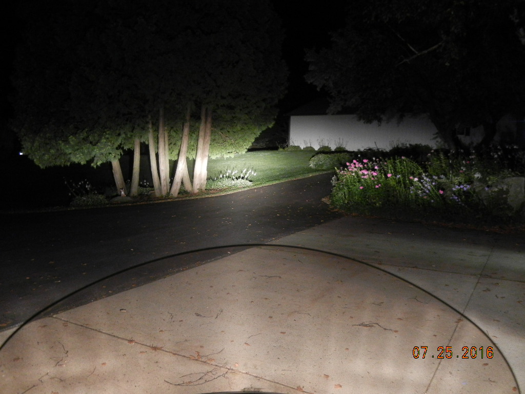

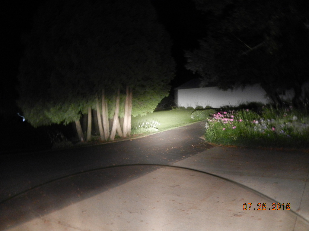

gggGary Posted July 26, 2016 #13 Posted July 26, 2016 (edited) Picture progression; stock, then Wagner BP1210-H4 100/80 from NAPA, now Broview S5 LED. I ran the Wagner for a couple weeks, stayed a bit worried about the high power draw, still wanted more light! now have installed an H4 LED, BUT not just any LED. We have a winner folks! The pics don't do it justice this is a major improvement. Possibly the "holy grail" LED we've been waiting for. One ride so far, I was able to put the bulb in without removing the fairing, um maybe not EASY but got r done. Hint; the instructions aren't super clear, you remove the H4 ring from the new bulb with a slight twist, install just the H4 ring with the factory clips, THEN install the the new bulb into the ring. I will probably pull the fairing front to properly stow and mount the power pack for the LED. Stock bulb 100 80 Wagner bulb Bro-view S5 LED The LED on low beam nice cut off, effective but not as harsh "pitch black" as some bulbs make it. I had to adjust the headlight down a bit which gave me a better road view on high as well. White road signs are pretty harsh, bright, in the high beam, but yellow signs are fine. A pair on flea bay, to my door from California in 5 days, $48 with shipping. Another vender advertised the Broview S5 with a single motorcycle option but shipped a different LED bulb with a fan, I sent that back. Bonus: the LED is advertised to draw 30 watts. half the stocker on bright. Edited August 12, 2016 by gggGary more testing and a winner!

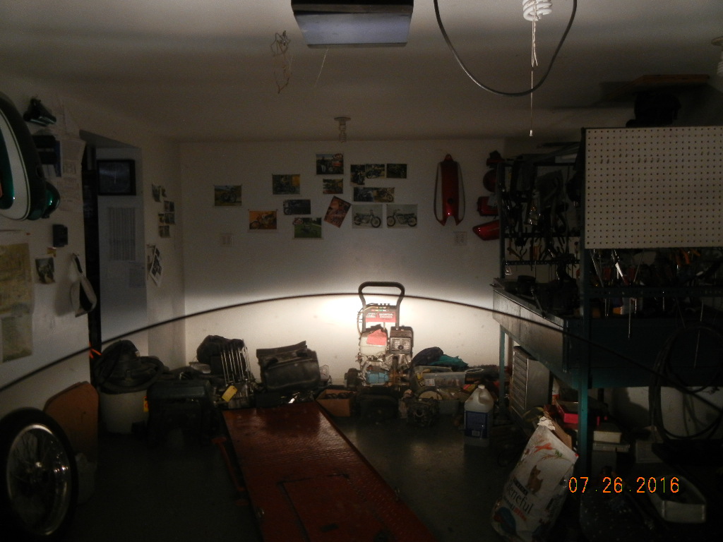

mm482 Posted July 26, 2016 #14 Posted July 26, 2016 I hope the 100/80 works for you, but I don’t think the wiring and connectors are large enough to carry the amps needed. I have seen several melt after a few miles.

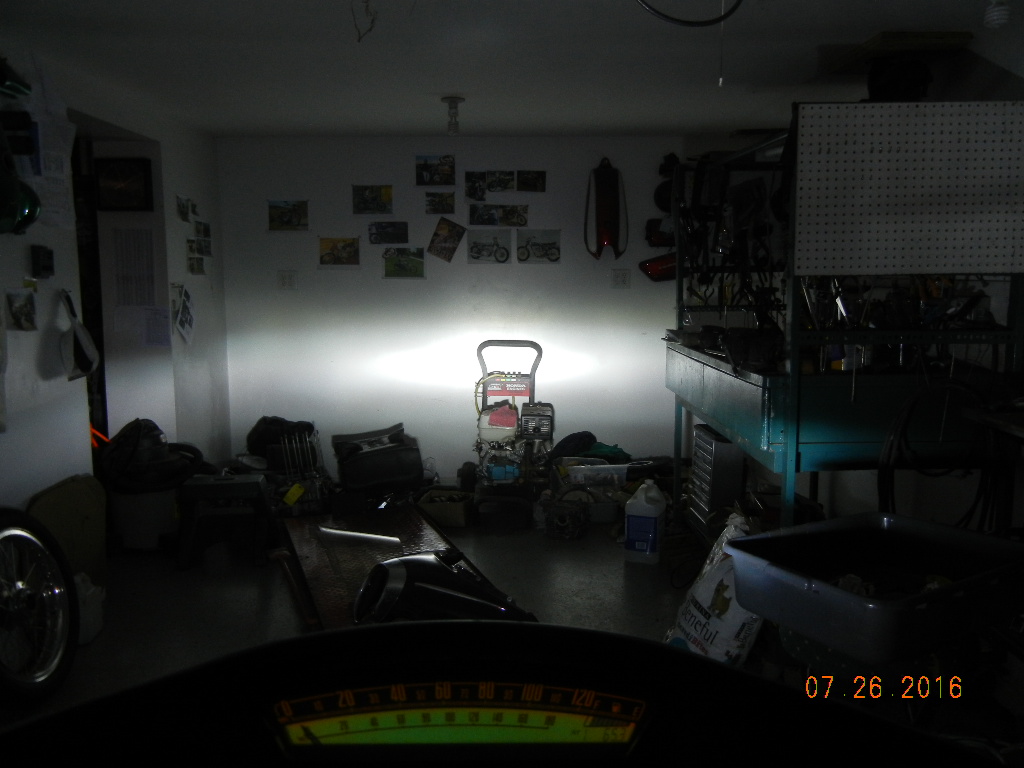

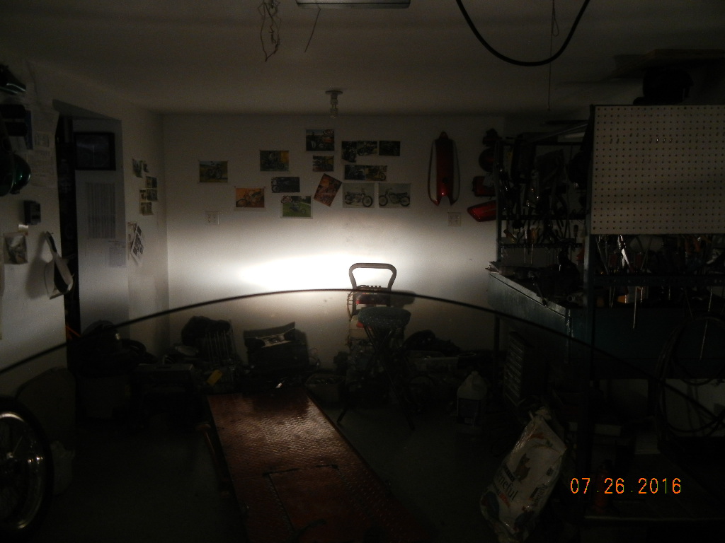

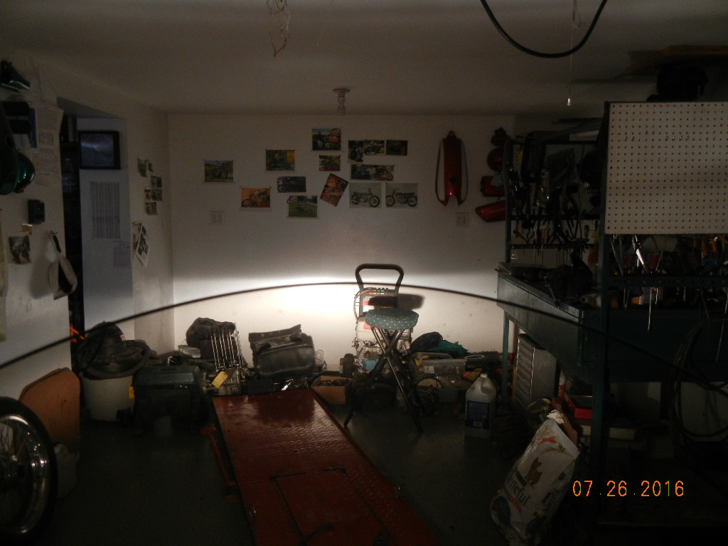

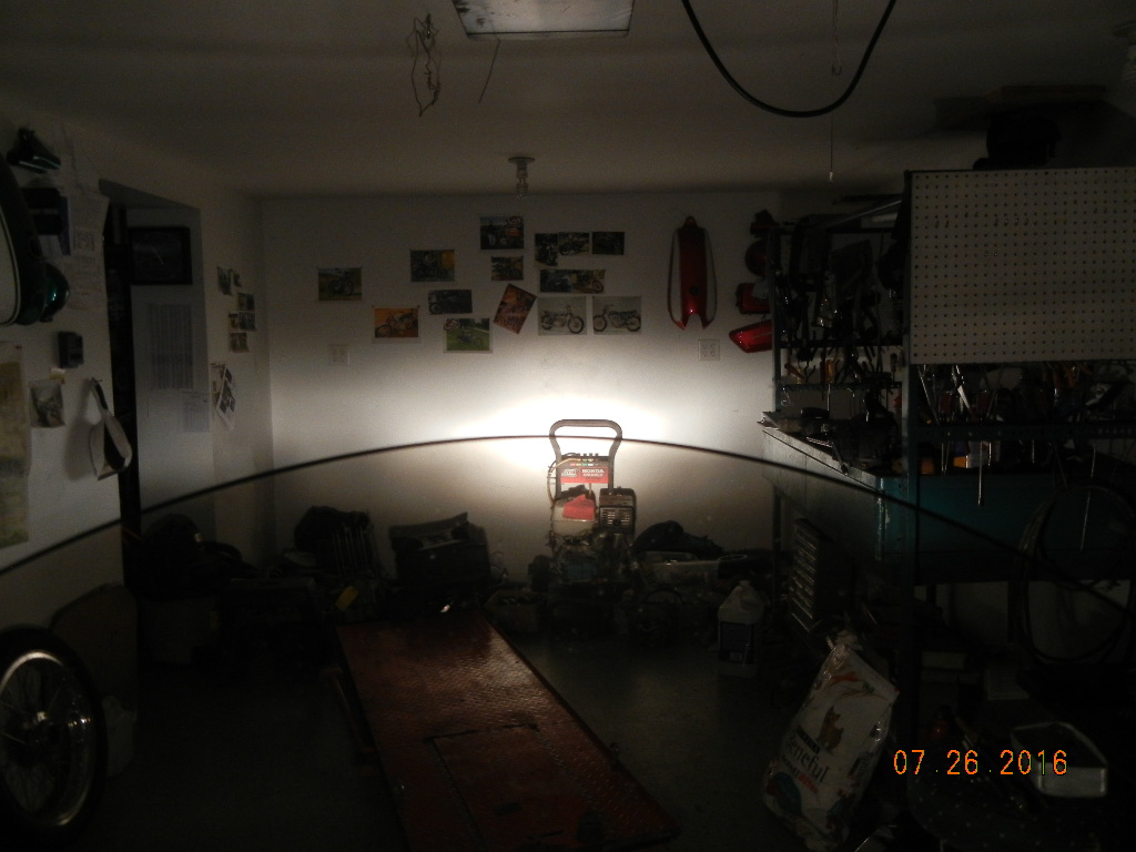

gggGary Posted July 26, 2016 #15 Posted July 26, 2016 (edited) I hope the 100/80 works for you, but I don’t think the wiring and connectors are large enough to carry the amps needed. I have seen several melt after a few miles. That is a concern of mine but I did a search just now and found no posts about melted wired wires. I do not have passing lamps which use "about" the same amount of current with the stock bulb as this one? My bike is a G2 that appears to have a metal reflector? NOTE: see post above, I changed bulbs again to the Broview S5 H4, put about 6K miles on so far with no issues. To my mind this is the answer to the RSV headlight question bike hasn't moved, dark garage. stock bulb low Wagner 80 watt low Stock bulb high / Wagner 100 watt high I also have an H4 HID kit will plug that in next..... turns out HID kit provides high beam only but here's the pic. Edited March 28, 2017 by gggGary pics! n more pics

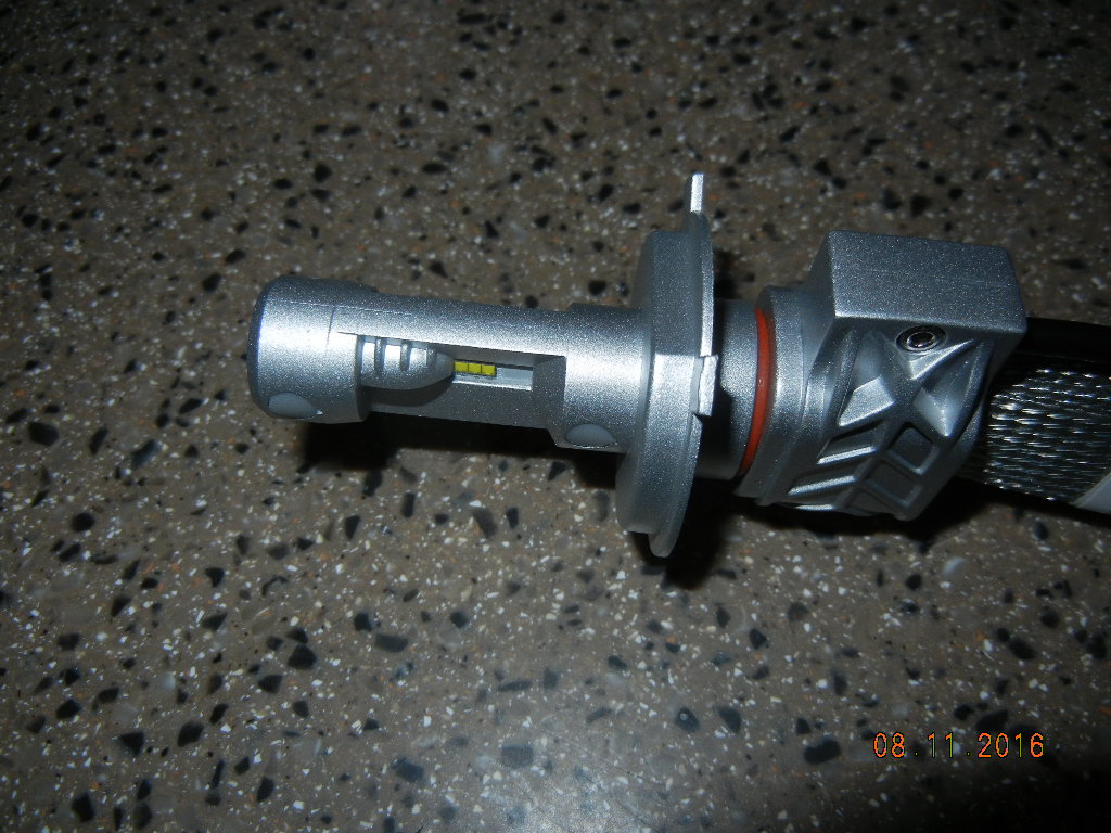

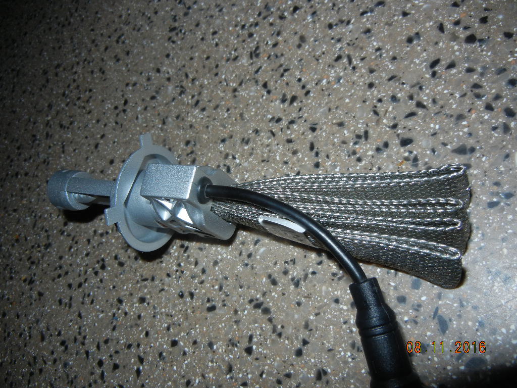

gggGary Posted August 12, 2016 #16 Posted August 12, 2016 (edited) Please see post # 13 above, I bought and installed a Bro-view LED last night, we have a winner! Note how they have shielding over the low beam for the cut off. We are looking at the left side of bulb, right side has the same design with perhaps a slightly different shield for "perfect" low beam cut off with raised right edge for "ditch view" This uses a copper braid heat sink, no fan, fits in fairing. I got flashed once on the first ride, I lowered the headlight a bit with the knob which actually improved both high and low view, no more "flashes" Edited August 12, 2016 by gggGary
videoarizona Posted August 12, 2016 #17 Posted August 12, 2016 Question: You bought an automotive pair of LED bulbs. Which one did you install in scoot? Left side or right side. They usually are different pattern...hence my question. BTW, thank you for the pictures and test results....helps a lot! David
gggGary Posted August 12, 2016 #18 Posted August 12, 2016 (edited) I believe they are identical, just like a halogen bulb is the same both sides? But I'll look at the remaining bulb to see if there are any markings as to left or right ;^) They do make the left and right headlight housings different and they use different housings and perhaps bulbs for cars (and bikes) in RHD countries like Japan and England. Edited August 12, 2016 by gggGary
