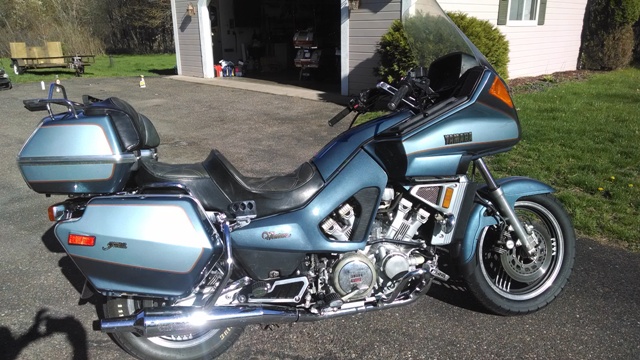

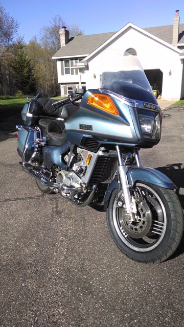

Got it out on the road over the weekend and I really like this bike!! I'd prefer to have a Royale, esp. post-85 with larger bags, but for now, I'll put miles on it til a really nice one catches my eye.
Looks great!! Well worth getting it 100%!!
PS somebody stole your aftermarket backrest, they are well worth having...
Nope, just didn't have it on the bike. Same with fairing lowers.
