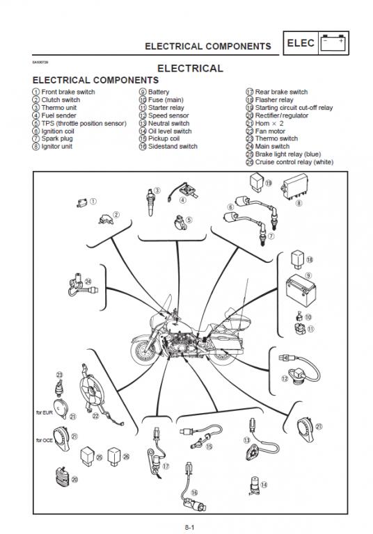

I'm not sure where the Starting System Cutoff Relay is located but I'm attaching a screen shot of pg 8-1 of the manual. It's number 19 and appears to be right behind the engine, pretty close to the Igniter

Yah Bob, it's in the center between the fake battery cover where the fuel pump and fuel filter are located. You have to take both phony covers off, and then remove that plastic piece that goes between the covers. You have to unclip the spark plug wires from the clips on that cover, and it takes a bit of wiggling and cursing to get it to finally come out! Remove the seat, and the radiator overflow tank, and unbolt the bracket that holds the fuel pump, etc.

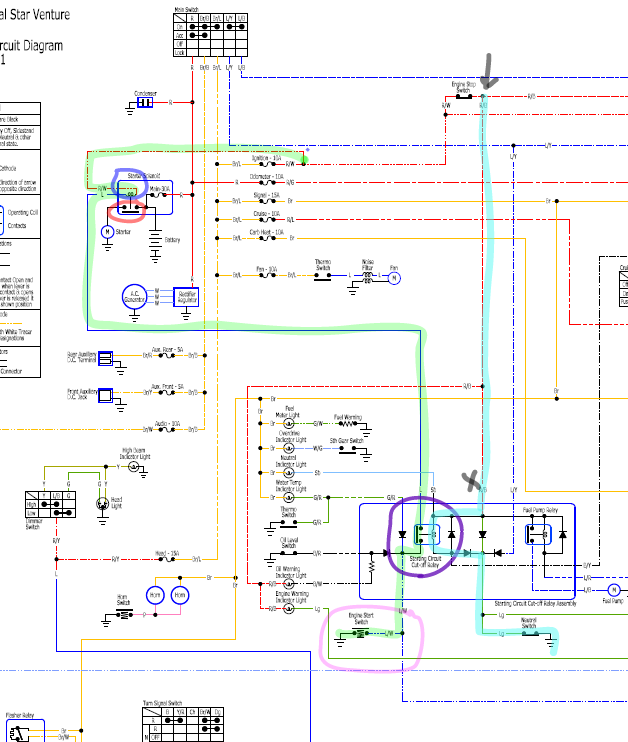

For those of you who might be wondering how it all worked out. See photo below. (for the following procedures we are ignoring the existence the diodes and the Fuel Pump Relay within the SCCR because they are not presenting any apparent problem at this point)
On the lime green highligted circuit, Bob and I verified current on
  • 12V on R/W at the solenoid
  • 12V on L at the solenoid
  • 12V on L at SCCR (Starting Circuit Cutoff Relay)
  • ...but no current at the L/W on SCCR
  • We verified continuity through the Engine Start Switch to ground
That meant that the SCCR internal contacts were not closed/activated.
In neutral with ignition on and Engine Cutoff Switch in run position The SCCR internal contacts should always be closed, thus allowing current to make it's way through the lime green highlighted circuit from the ignition fuse all the way to ground at the Engine Start Switch causing the Starter Solenoid to engage the starter motor.
So now we had established that the problem was in the coil side of the SCCR circuit (light blue highlighted circuit)
We then began our trace at the (X) on SCCR to determine whether the problem was north or south of the SCCR.
  • No current at R/B at SCCR (X)
  • Went north to the connector for the Engine Stop Switch (arrow)
  • Engine Stop Switch in Run
  • 12V on R/W at the connector but...
  • No current on the R/B at the connector. So we fooled around with it a bit, got 12V , hit the start button and...
VAROOM! Another dragon slain!
