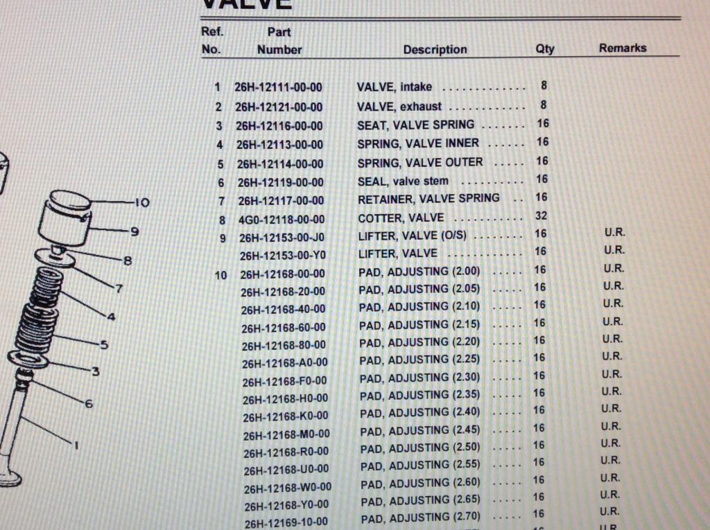

Trader Posted April 19, 2016 Author Posted April 19, 2016 In the parts list for valve lifters (or shim buckets as they have been called) there are 2 listings see picture...both are part #9 26H21153-00-J0. LIfter, Valve (OS).......16. U.R. 26H21153-00-Y0. Lifter Valve ..............16. U.R. What at does the (OS) mean and what does U.R. mean?
Flyinfool Posted April 19, 2016 Posted April 19, 2016 Just a Wild ass guess. O/S could be Over Size? U.R. could be User Replaceable? Purely a guess on my part. Since all of the Shims are marked U.R. and the correct one to use must be determined by the mechanic.
Trader Posted April 19, 2016 Author Posted April 19, 2016 you're right again! Is it getting hard to be humble? lol I found this on google... Keys to symbols U.R Use size (thickness) and/or number as required couldn't find anything on "OS"
