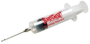

Syringe?
Large syringe like you would use when injecting a marinade into meat. Most have a screw-in needle that you wouldn't need in this instance, as the "tip" alone should be small enough to fit inside the schrader valve.
