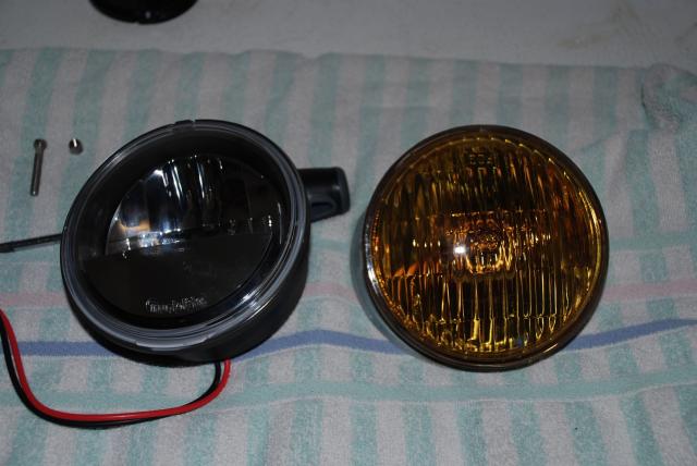

1. Here are the Truck Lite 4.5 LED Lamps I installed
[ATTACH=CONFIG]103404[/ATTACH]

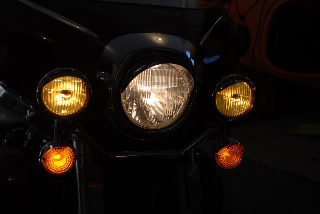

2. Here is how they look next to the PAR 36 -front
[ATTACH=CONFIG]103405[/ATTACH]

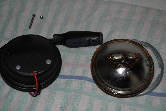

3. And back.
[ATTACH=CONFIG]103406[/ATTACH]

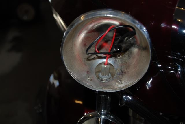

4. Now to fit them in the bucket is tricky as they barely fit due to the thickness of the bottom back of the new lamps. They end up pressing against the stud inside the lamp bucket and then attaching the retaining ring becomes a game of patience as you have to press hard against the lamp, align the spacer behind the lamp, align the hood on the lamp and then tighten the screw at the bottom. Took me a couple of tries to get there and was about to enlist a few extra pairs of hands, but it came together.
[ATTACH=CONFIG]103407[/ATTACH]

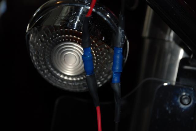

5. They come with a stock HD connector. I cut it off and replaced with male/female connectors and heat shrunk everything, used dielectric grease and made my connections.
[ATTACH=CONFIG]103408[/ATTACH]

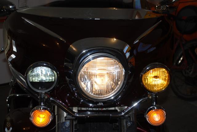

6. Here is how bike looked before I started
[ATTACH=CONFIG]103410[/ATTACH]

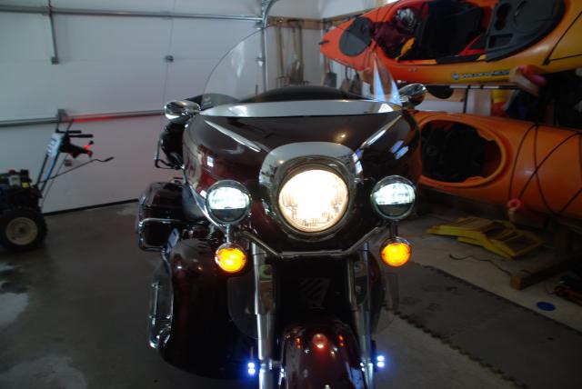

8. and with both done. Headlight now looks a bit dim.
[ATTACH=CONFIG]103411[/ATTACH]
