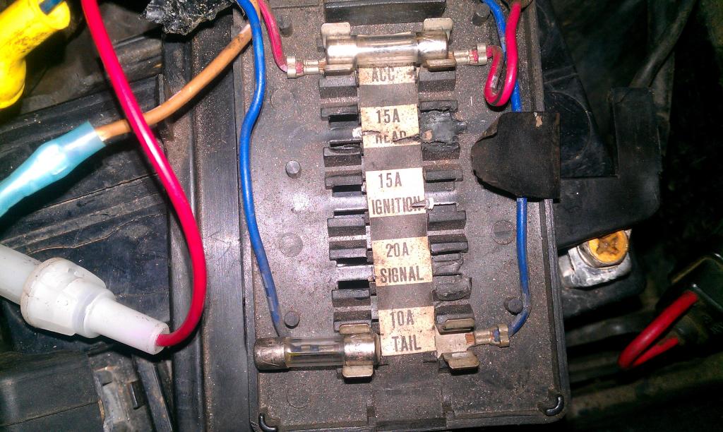

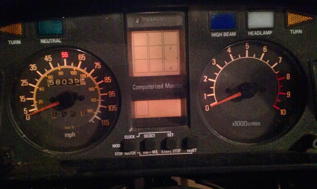

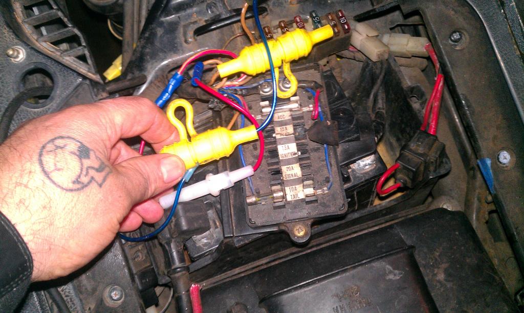

Zippy69 Posted March 12, 2016 Author #12 Posted March 12, 2016 The first pic shows the inline fuses the second shows the fuse block and whats left wired in. the third shows the display. No neutral light, fuel gauge etc. What send the info to the display?
Prairiehammer Posted March 12, 2016 #13 Posted March 12, 2016 Zippy69 said: No neutral light, fuel gauge etc. What send the info to the display? The "SIGNAL" fuse (Brown wire in, Brown wire out). In your picture, I don't see any wire coming out of one end of the upper (in pic) yellow fuse holder?

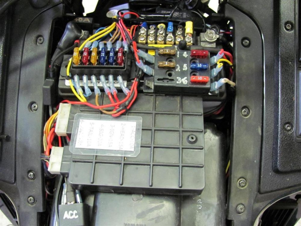

Prairiehammer Posted March 14, 2016 #18 Posted March 14, 2016 Zippy69 said: Quote Going to change out the fuse holders with ATC type Go here for my write up about changing my fuseblock on my 1990: http://www.venturerider.org/forum/showthread.php?66650-Upgraded-and-updated-Fuse-block%28s%29&highlight=fuse+block And here is the before picture of my 1991 fuse situation: And here is the after: Quote Also, forgot to mention that the bike never had power to the CLASS. The CLASS fuse is in the rubber inline fuse holder.
