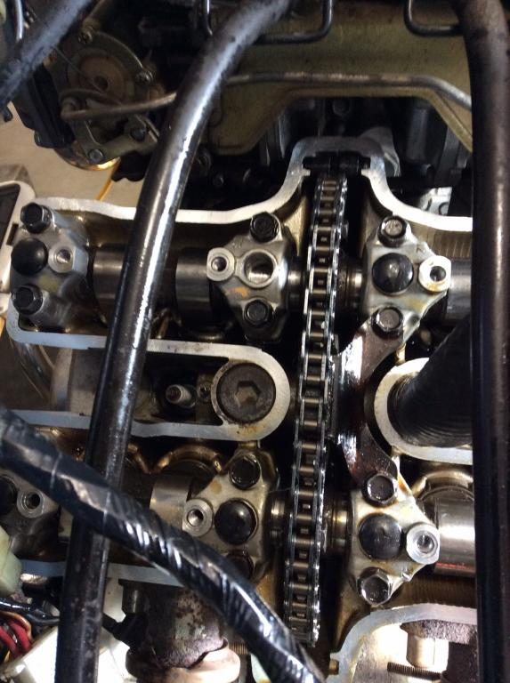

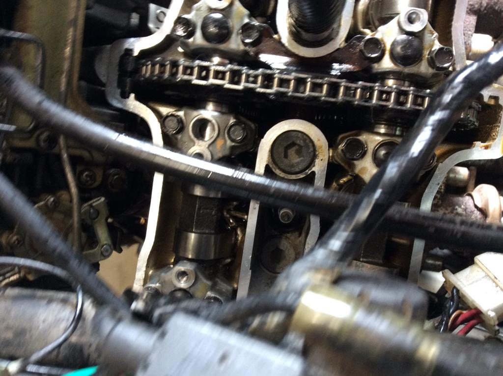

Trader Posted February 13, 2016 Posted February 13, 2016 I recently posted how our titles of threads should be specific....this one is! I removedthe valve covers....first thing on the list? Make sure oil caps are in place. NOPE! One is missing. I looked EVERYWHERE! If it fell down beside the cam chain then it went right down...not wedged anywhere I can see. I literally spent over an hour looking in every nook and cranny on the bike, on the floor, on top of the collector, top of shock....EVERYWHERE!! so like I said...OH CRAP my dumb question of the day....can I leave it? If it did fall into the guts will it just get ground up and end up in the filter? I can see a concern of blocking any oil ports....but I don't know what to do! HELP!!!!!!! 2nd question.....save me tearing into my parts bike engine.....does anyone have one open where they can send me one?

Trader Posted February 13, 2016 Author Posted February 13, 2016 You can see them at 9&3 o'clock to hex bolt 9:o'clock is gone Pretty sure they are plastic or rubber

cowpuc Posted February 13, 2016 Posted February 13, 2016 You can see them at 9&3 o'clock to hex bolt 9:o'clock is gone Pretty sure they are plastic or rubber Top picture, look carefully at the header manifold mount bolts, bottom bolt has something black laying right in front of it,,, could it be????
Freebird Posted February 13, 2016 Posted February 13, 2016 I agree with the Pucster. Sure looks like that could be it. If it is, that is a GREAT catch Puc...I would have never seen that. Had to look very carefully even after you pointed it out.
Trader Posted February 14, 2016 Author Posted February 14, 2016 Sorry Pucster No joy in Traderville you were right...something black...the side cover rubber bungee still hanging on the clip
cowpuc Posted February 14, 2016 Posted February 14, 2016 Sorry Pucster No joy in Traderville you were right...something black...the side cover rubber bungee still hanging on the clip WELLLLLLLL,,, RATSSS,, worth a shot brother!! I REALLY like Flyinfools suggestion about the Harbor Freight inspection camera!! Perfect time to make an addition to the Man Cave tools if nothin else.. If you do that it might not be a bad idea to check the inspection cable end of the apparatus - get the smallest one you can find.. Be wayyy cool if you could get one with a small enough end that it would go into a spark plug hole - remember our scoots have smaller plugs (thinking 12mm).. Wish I had one I would loan it to you..
