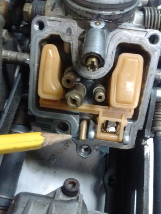

MiCarl Posted February 14, 2016 Posted February 14, 2016 Ok, I just had a look at the carbs on my bench. The needle jet is not in your pictures. The jet itself is ahead of the float pivot. I took a picture that I'll post when I get home later. The emulsion tube is center left in your first picture, main jet holder screws around it. The holes in there are what need to be clean. Have to clean them in place - it's pressed in. If you spray carburetor cleaner in through the air jet it'll come out the holes in that tube - then follow with compressed air. That's all you need.
MiCarl Posted February 14, 2016 Posted February 14, 2016 Here is the picture. Pencil is pointing at needle jet.
Guest Jamsie Posted February 14, 2016 Posted February 14, 2016 thanks carl . i was thinking the needle jet was under the main jet and main jet holder
MiCarl Posted February 14, 2016 Posted February 14, 2016 thanks carl . i was thinking the needle jet was under the main jet and main jet holder With side draft carburetors it is. On down draft it has its own well. On the 1st gen they are removable, but they're unusual in that respect.

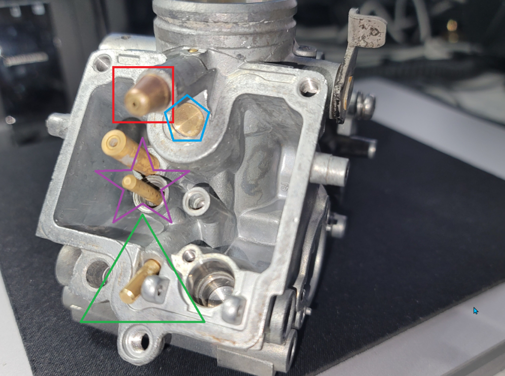

OleBrown Posted February 26, 2023 Posted February 26, 2023 Can someone please help me identify these components in this carb? Does the Red Square cover the Pilot Gas Screw? Or is it under the Blue Pentagon? What is the the brass piece identified in the Green Triangle? It appears to aligned with the needle jet, which is what I think I want to remove, but is may be pressed in. Finally, is the emulsion tube identified within the Purple Star? Can it come out to clean it?
