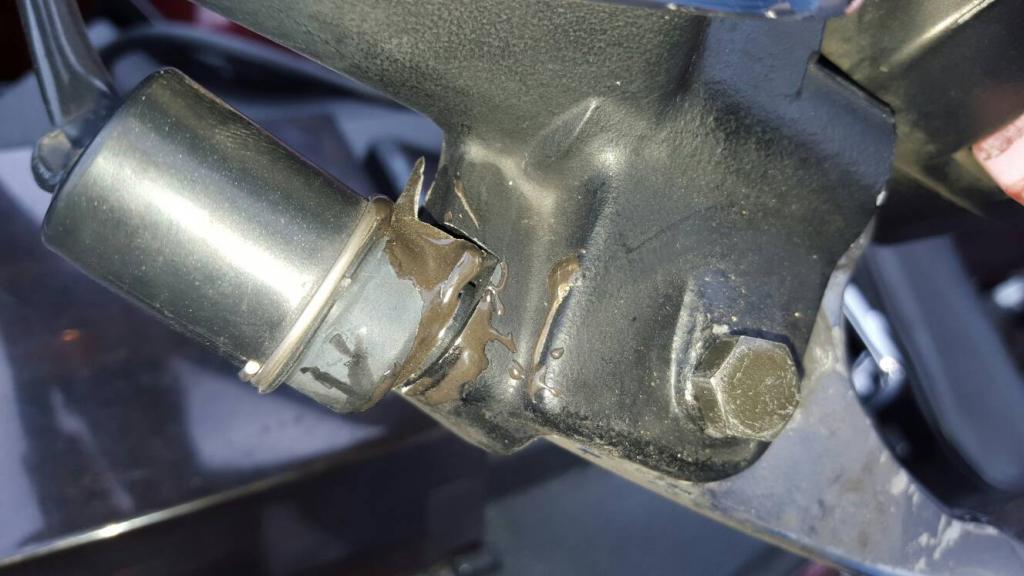

[ATTACH]103268[/ATTACH
I just noticed this. Does this mean my clutch master cylinder is broken?
Sent from my SAMSUNG-SM-G920A using Tapatalk
No.
The tab on the switch is broken. Someone tried to glue it in place.
With it hanging out like that your cruise control won't work and it'll probably start in gear without pulling the clutch.
I have to push the clutch lever out for the cruise to work what switch is that that is broken
If you have to push the clutch lever out to get the Cruise to work, you have a problem with the clutch switch. Usually this only takes adjusting the clutch to rest forward.
:farmer:
With the housing broken like that I would clean it up good. Make sure the switch is lubed good and JB Weld it back in place. Might work might not but it ain't working now???
