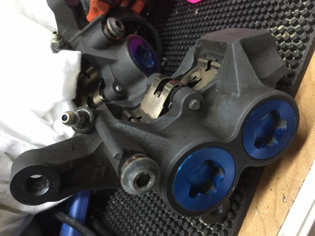

Gdub Posted February 1, 2016 #6 Posted February 1, 2016 Do the R6 calipers use the same type connection for the banjo fitting as the original calipers? I was thinking of installing R6 calipers on the front but didn't know if I would have to install new brake lines at the same time or if I could do it later.

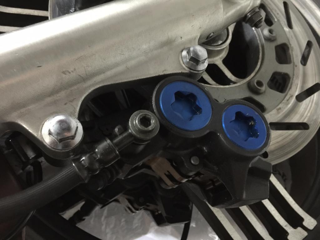

VanRiver Posted February 1, 2016 #7 Posted February 1, 2016 (edited) Do the R6 calipers use the same type connection for the banjo fitting as the original calipers? I was thinking of installing R6 calipers on the front but didn't know if I would have to install new brake lines at the same time or if I could do it later. Hi @Gdub - Yes they do, my R6's just bolted right on my 1986 Royale's using the existing brake lines and bolts (I used the Allen key bolts from the R6 just because they looked nicer then my old ones). Only thing is that the banjo bolt location on the R6's is on the side rather then top like the old calliper.......not a big deal as all the lines still fit, only thing is the Optional VentureLine chrome calliper covers I had no longer fit due to the side bolt location. Oh well, I like the "blue dot" look better of the R6's anyways. Nice and simple upgrade. Here are a couple of pic's of my "Blue Dots". I have an extra set sitting on my bench ready to be cleaned and installed on "AZZI" my other Venture waiting for me in Arizona. Hope that helps! Edited February 1, 2016 by VanRiver
Gdub Posted February 1, 2016 #8 Posted February 1, 2016 Thanks for the great pics and advice VanRiver! It looks like an upgrade I definitely want to do.
