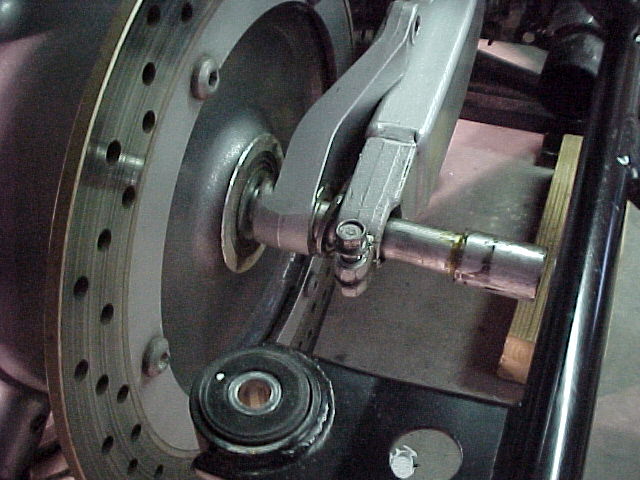

todd493 Posted January 26, 2016 #1 Posted January 26, 2016 Hey all! Just dropped the rear tire out of my '05 for an new Elite 3 fitment. This is the first time I've changed a tire on the RSV. I noticed that the washer on the brake caliper assembly was on the wheel side and not the swingarm side as pictured here- http://www.venturers.org/Tech_Library/?action=article&cat_id=002014&id=323 I'm thinking I need to reassemble as in the picture, I've checked a couple other threads and swingarm side seems to be the standard mounting. Is this a correct finding? Thanks!
etcswjoe Posted January 26, 2016 #2 Posted January 26, 2016 It goes on the swing arm side here is another pic and a write up. http://www.venturerider.org/forum/showthread.php?515-Rear-Wheel-Removal
OutKast Posted January 28, 2016 #3 Posted January 28, 2016 If it was on the wrong side, check your caliper and rotor. I put it in wrong the first time on my 04, and the caliper drug against the rotor, so much so I immediately knew there was a problem when I tried to spin the wheel.
