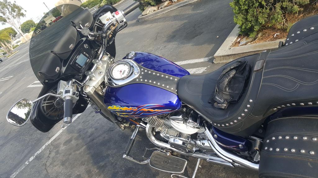

michaelclaw Posted March 21, 2016 Author #35 Posted March 21, 2016 Finally got my bike back after 3 weeks! Put my fairing on and highways bars (they are crash bars but larger) and i'm really liking my bike, just need to paint my bike black to match the fairing cause i'm riding around on a purple bike with a black fairing lol. Found out one of my main jets were frozen and he said the carbs were dirty and it took him like 8 hours to clean! Also had cracks in my intake boots and a tear in the main diaphragm, after having the fixed, it's like a new bike. The bike is like a rocket ship! 0-60 in like 3 seconds. Just ordered venture headers and stock mufflers so that hopefully will give me better compression and a performance boost. Anyways wanted to update you guys
