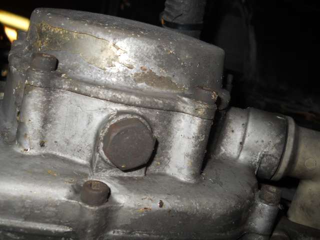

jfman Posted March 7, 2016 Author Posted March 7, 2016 Thanks cowpuc is there an oring in there? hard to replace? It does leak when I ride, only did what the buke was cold.
cowpuc Posted March 7, 2016 Posted March 7, 2016 Depending on where its leaking from Jf, the cover that goes over the water pump does have an o-ring seal on it - this would be a very easy repair job. The impellar, which you would find under the cover with the o-ring in it, is mounted to a small shaft that passes thru a mechanical seal and a regular oil seal on its way into the drive gear that drives the water pump. There should be a weep hole on the underside of the water pump casting that allows anti-freeze to escape if the mechanical seal fails (or a bearing goes south).. If the water is coming from that weep hole than its a little more involved because the water pump has to come all apart to fix it.. Most of these older bikes "weep" when they are cold from the hose connection area under the radiator where the little plastic hex head valve is located.. Usually they stop completely when they warm up.. It sounds to me like this is NOT your issue - your issue sounds more like a failing water pump mechanical seal. Here is a link to the water pump diagram. The cover o-ring would be part #9 , the impellar mech seal is #8 .. A common issue with mechanical impellar seal failure is that anti freeze can find its way into your engine oil - all it has to do is get beyond the oil seal that is the next seal in toward the engine on the shaft.. Have you noticed any "muddy" look to engine oil? I had a water pump seal fail out in the middle of no where while playing in Utah one time.. I finished the trip up with all the way back to Michigan by running my rad cap loose - not advising you to try it BUT it did work.. Just running with the cap loose allowed enough pressure to be released that I lost a lot less water.. Another place to check very closely would be that plastic tube that feeds into the waterpump case. This would be part #21 on the diagram. That tube does have o-rings also and it is not uncommon for them to leak should the tube get bumped.. If it is leaking from that area, a little carb cleaner cleaning, scratch er up with some sand paper and spray again with carb cleaner - stop at a Walmart or an Auto parts store and purchase some "Seal All" before you start to clean it up.. Coat the tubing joint up with seal all real well before you hit the sack for a night and by the next morning you should be good to go... Thinking first thing is to find out exactly where the water is coming from first thing Jf... ooppsss,, almost forgot diagram http://www.yamahapartshouse.com/oemparts/a/yam/50042846f8700209bc788cdf/water-pump
jfman Posted March 8, 2016 Author Posted March 8, 2016 Thanks ! Pretty sure I need to replace seals #22 but I guess since I am ditching the bike, I can patch it from the outside for a temp fix l like you said. No need to drain the whole system this way.
cowpuc Posted March 8, 2016 Posted March 8, 2016 Thanks ! Pretty sure I need to replace seals #22 but I guess since I am ditching the bike, I can patch it from the outside for a temp fix l like you said. No need to drain the whole system this way. COOL - glad it's not a water pump!! Here is what I would suggest.. Find something to drain the anti freeze into, pick up a can of cheap carb cleaner and a sheet of medium grit sand paper, get some "Seal All" (comes in a Yellow Tube - Red Print) from Wally World or an Auto Parts store (good stuff and cheap). Get to a motel where the bike will sit over night. Pull plug #11 shown in the diagram - located under the water pump (also seen in attached pic) and drain the system - really best if you drain the system so the seal all has a chance to bond. After draining, wipe down area on both plastic tube and area where it slides into pump.. Sand the area - both plastic and aluminum case - really well, spray it off with carb cleaner and sand again after carb cleaner drys. Spray off again with carb cleaner.. make sure there is no anti freeze still seeping and area is good and dry. cover area with seal all but not to thick - it should go on fairly runny. Seal All first coat over the joint about 1/2 inch on each side of leak. Let dry for couple hours (longer is better) and then re-apply next coat out to an inch or so.. Now let that dry till your ready to leave next morning.. Put the plug back in and refill the rad.. Have had REALLY good luck with Seal All getting me back on the road.. Punched a hole in a case one time - you could literally look in and see gears - made a patch out of Seal All and gum wrapper tin foil - worked AWESOME!! Hope it works for you and you make er to MeHeeCoe!!!

jfman Posted March 8, 2016 Author Posted March 8, 2016 Well it is def the angle pipe seal that is leaking. I can see it clearly today. A weird thing this bike does is when I turn on the blinkers sometimes I lose the rpm and volt meter gauge for a split second. It only does it if I have not used the blinkers in a while. The needles drop but come right back up and the icons in the center of the dash all light up for a split second. weird
