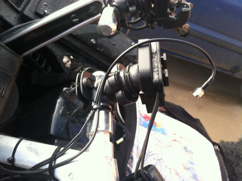

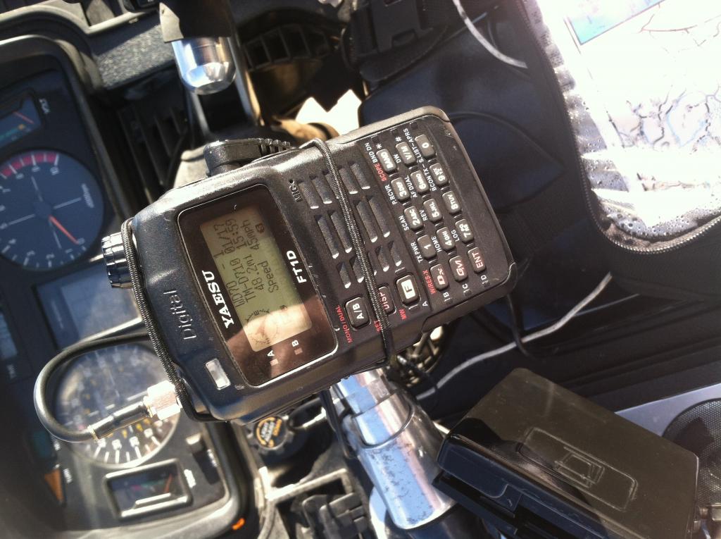

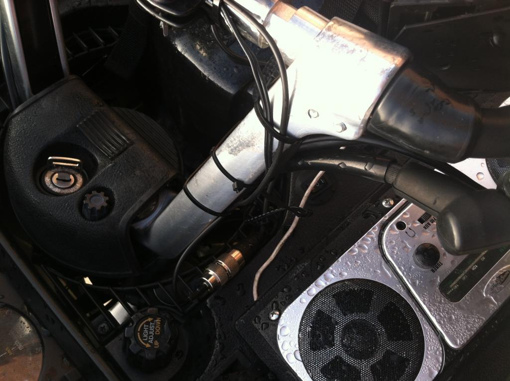

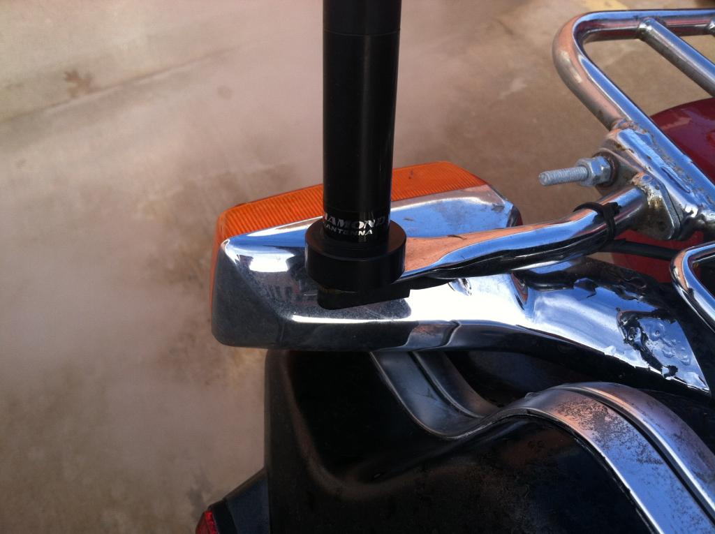

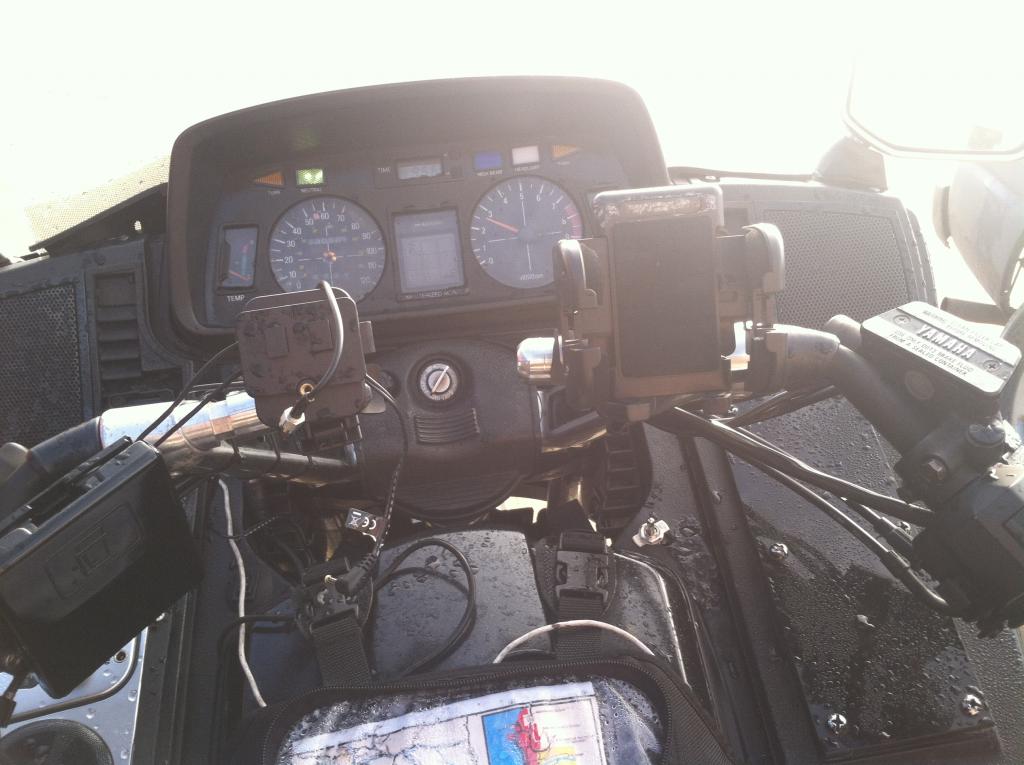

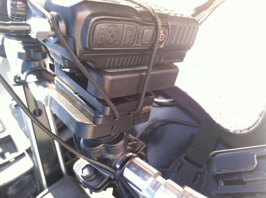

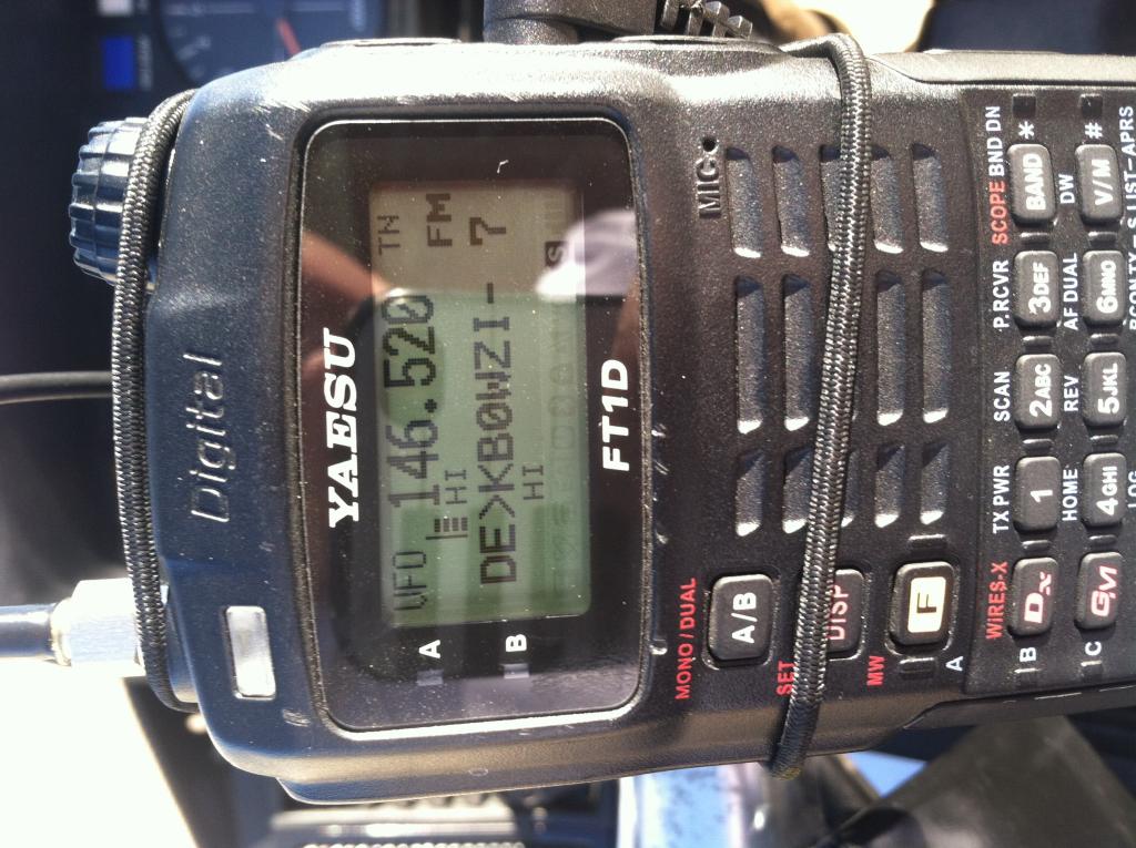

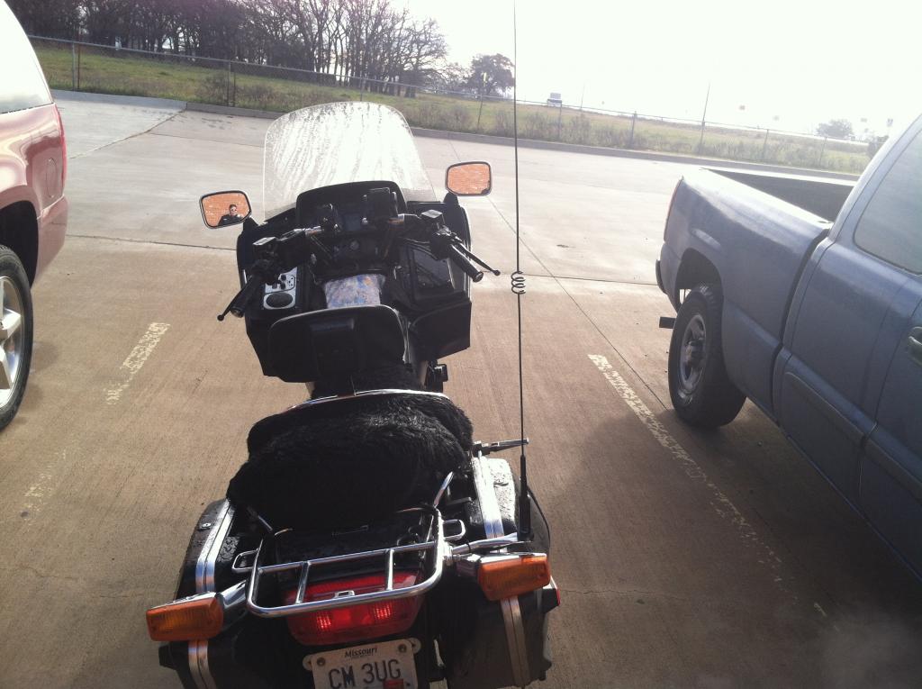

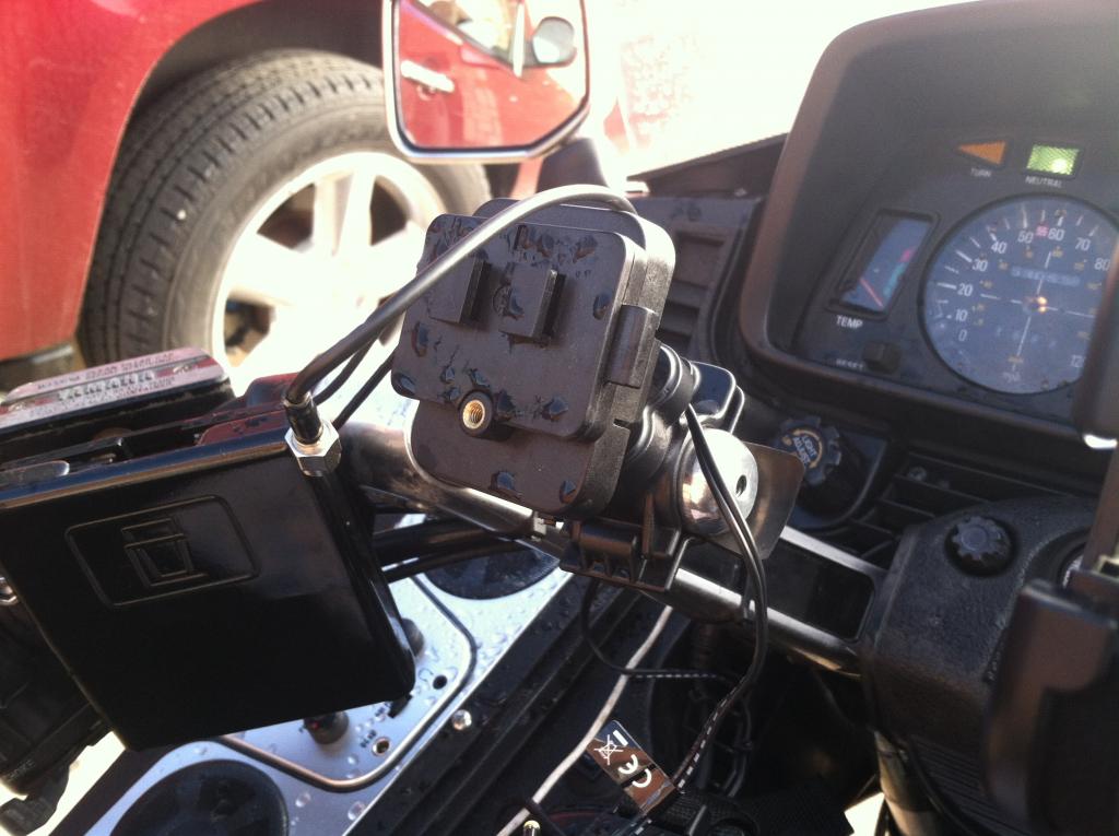

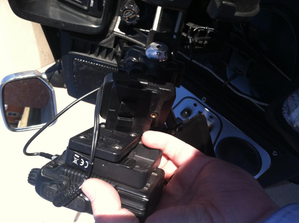

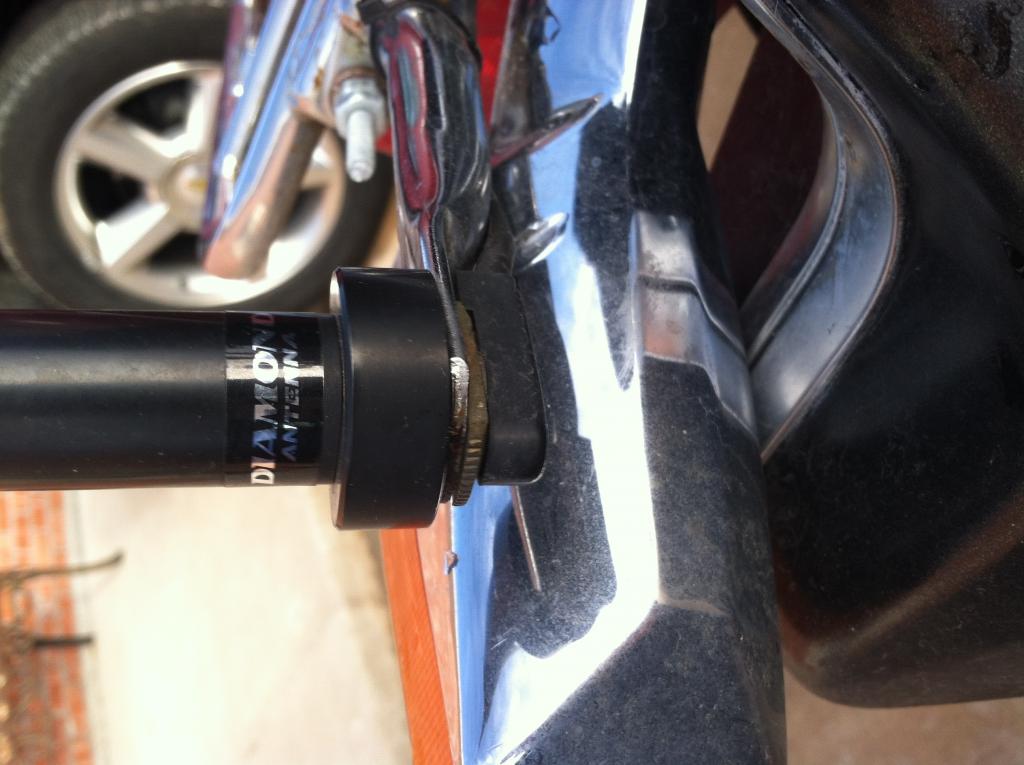

BigClayton Posted January 17, 2016 Author #29 Posted January 17, 2016 @Larry1963 Hi Larry and crew, wanted to upload some pictures of my Ham radio setup. The radio has a GPS built into it and transmits my position every 2 minutes (or I can change the time). My bike didn't have the radio or any of the fancy stuff. It was a plane jane. I ordered the antenna mount off ebay thinking I would just use a mirror mount bracket to clamp on an antenna too. Once I got it, I just for kicks tried an NMO surface mount and it fit the hole just perfect. I then ordered the 5/8 wave dual band antenna due to lack of ground plane. Screwed it in and routed the wire up to the front. I use a adapter cable to go from pl259 to TNC for the radio. This radio has Shortwave, AM, FM radio, ham bands and many other options. When I get the Sena SH10 i'll be able to use my Sena SR10 headset with the PTT to talk on it too. I'll use this as my AM/FM radio and multi purpose receiver too. I'm having some issues figuring out how to turn the photos upright. After they upload, they seem to turn so not sure. The radio is upright when I look at it. If you have any other questions please let me know. The APRS network is pretty active. http://www.aprs.fi opens a google map with APRS stations overlayed. You can zoom in and out and this will giver you an idea of the coverage.

Larry1963 Posted January 19, 2016 #31 Posted January 19, 2016 @BigClayton Hey thanks for the pics, I did not know anyone else besides Yaesu VX-8GR made an HT with APRS built in. I looked on QTH.com and seen a FT1D for sale but listed in December, so I have emailed him to see if it is still for sale. I have an 07 RSV and I would like to take the CB out and put in a 2 meter rig. But I hear a lot of the guys traveling in groups still use CB. I would like to put APRS on my bike. Not sure if it is a good idea, then the wife could keep track of me LOL. Funny story, when APRS was first coming out, the ham club I was with was helping with a bike ride (peddle bike) and we put APRS on a couple of the bikes. Well I borrowed a radio and I was playing with it. I had it in my car, and I sent out several messages to people to say hey check the aprs web site to see if you can track me. I forgot it was in my car. My wife calls me one day and ask, where you at. Oh in the office I replied, she says why does APRS say you are at Zaxby's........ For those up North or West, Zaxby's is a buffalo chicken chain around here, that I just love to eat at. So much so my wife was like you are eating there to much. So from then on, when I was going out to eat, I would leave the APRS (VX-8DR) in a bush near to where I parked my car at work........ However a good use for APRS, I use to get paid by the miles and the church I was at was kind of picky where you went. I would just print out a map each day and that way they knew who I visited. I am planning a couple long trips this year, one is to MO, I would like to have APRS so wife and others can know where I am at. Again thanks for the info.
