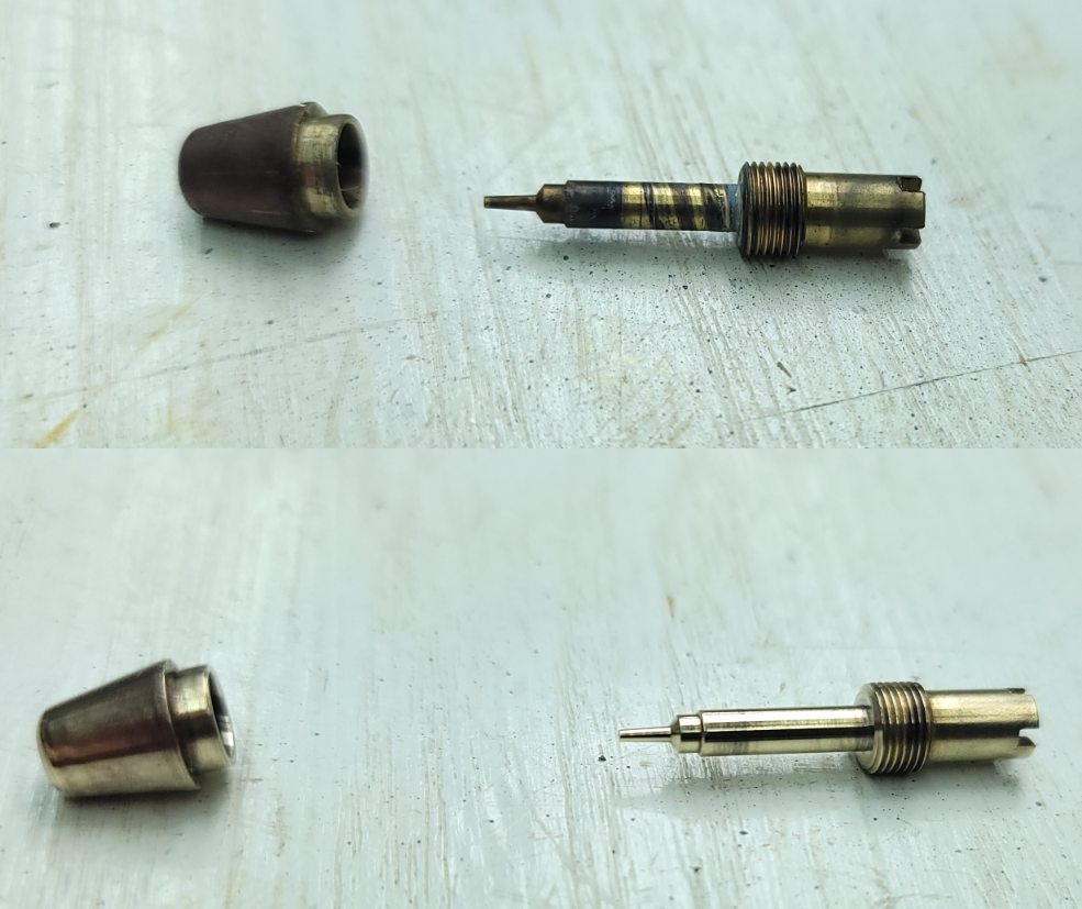

OleBrown Posted March 25, 2023 #5 Posted March 25, 2023 Here is a before/after of my pilot screw cleaning effort
