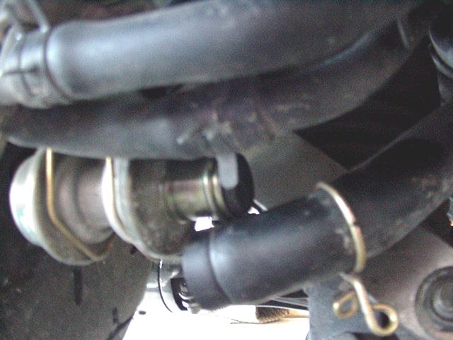

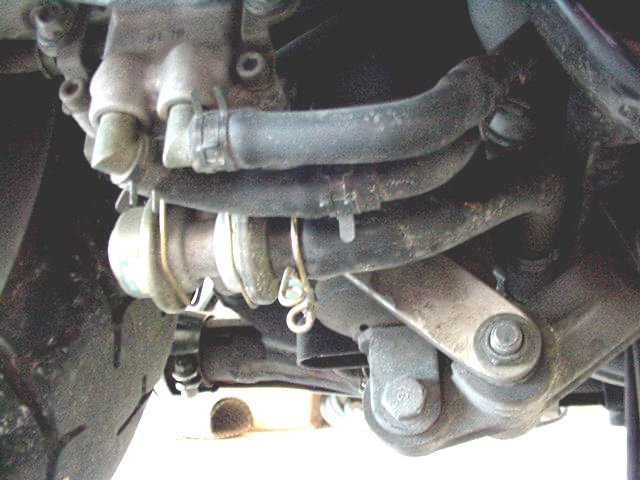

On the right side of the bike, just below the rear shock, you will find the first one.
You'll want to disconnect the large hose with the gold clamp.

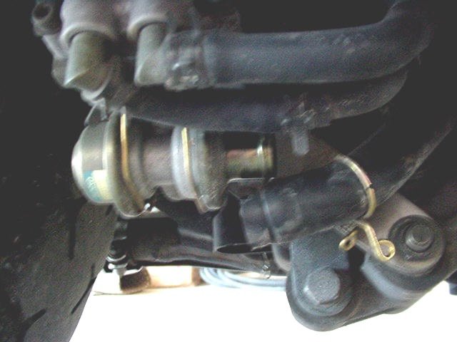

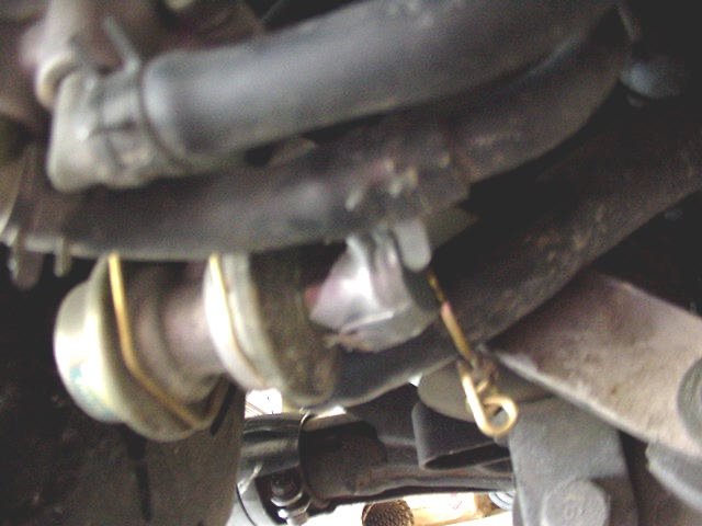

Now..you can use most anything to plug the hose. I used rubber stoppers that I had picked up at a local Home Depot store. You can find these in the hardware department but a wooden dowel rod or most anything of the proper size will work fine.
Look carefully and you can see that I have stuck the rubber stopper into the inlet on the AIS valve. Now in this next picture, I've simply stuck a piece of duct tape over the end of the valve and stopper. You can probably skip this step if you want but being born and raised in Texas...it's just part of my upbringing. Any job worth doing is worth using a bit of duct tape on. :) Besides...it keeps the plug where I want it and not up in the hose somewhere.

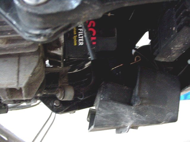

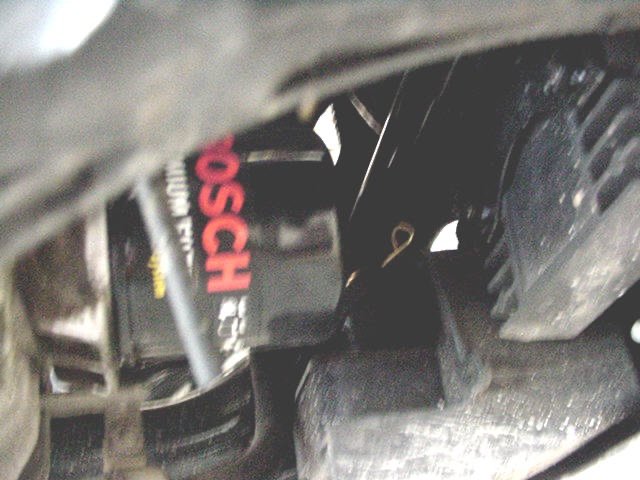

Now the front AIS valve is located just in front of the oil filter. The attached blurry picture is a bit hard to see but you can see the gold clamp that secures the hose you'll need to remove.

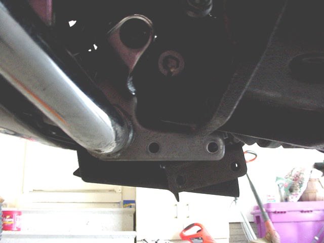

If you are ready to do this and you are not ready for an oil change, here is a tip that will make it easier. Just below the drivers floorboard on the left side of the bike (shifter side), you will see two allen bolts. These are the bolts that secure the AIS assembly in place.
Remove those two bolts and the assembly will be free, held only by the hose that you will disconnect.

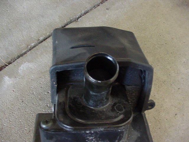

Once the hose is off, the assembly just drops out.
Now...just plug this hole in the assembly as you did on the rear. Put it all back together and you are done. Not a difficult job at all. Figure about 30 to 45 minutes total.
