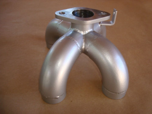

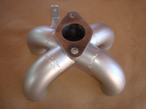

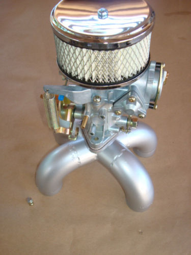

Prairiehammer Posted December 23, 2015 Posted December 23, 2015 Better Pic [ATTACH=CONFIG]102852[/ATTACH] I suspect that the large plenum is the cause of the flat spot. That general style manifold is notorious for poor low speed performance.
Prairiehammer Posted December 23, 2015 Posted December 23, 2015 Thanks for the input guys. That's what I was thinking, There has to be some way to run this thing on one carb. Being this is a project (one of too many) I'm going to start with the Holley. Jets, restrictor plate, maybe stuff a rag down one throat, I already have the carb, wonder if a small block chevy would fit under it? If nothing else it should be a learning experience. I have parts ordered, So keep the ideas coming and THANKS again for all the input! I don't think the size of the current carb is necessarily the issue, rather the manifold design is. Many 1300cc VW engines run with a 300-350 cfm Weber or Solex just fine. There is a single carb manifold kit for the Venture offered on eBay. Note the manifold design. http://www.ebay.com/itm/YAMAHA-VENTURE-XVZ1200-1300-SINGLE-VW-CARBURETOR-CONVERSION-MANIFOLD-KIT-/252185542008?hash=item3ab76dfd78:g:~A0AAOSwFnFWDTq6&vxp=mtr
Flyinfool Posted December 23, 2015 Posted December 23, 2015 I don't think the size of the current carb is necessarily the issue, rather the manifold design is. Many 1300cc VW engines run with a 300-350 cfm Weber or Solex just fine. There is a single carb manifold kit for the Venture offered on eBay. Note the manifold design. http://www.ebay.com/itm/YAMAHA-VENTURE-XVZ1200-1300-SINGLE-VW-CARBURETOR-CONVERSION-MANIFOLD-KIT-/252185542008?hash=item3ab76dfd78:g:~A0AAOSwFnFWDTq6&vxp=mtr [ATTACH=CONFIG]102880[/ATTACH][ATTACH=CONFIG]102881[/ATTACH][ATTACH=CONFIG]102882[/ATTACH] That is the one that I have seen referred to. Someone on this site tried it and also had issues with low speed performance. But I can not find that post to see what the final result was. It was a long time ago.
