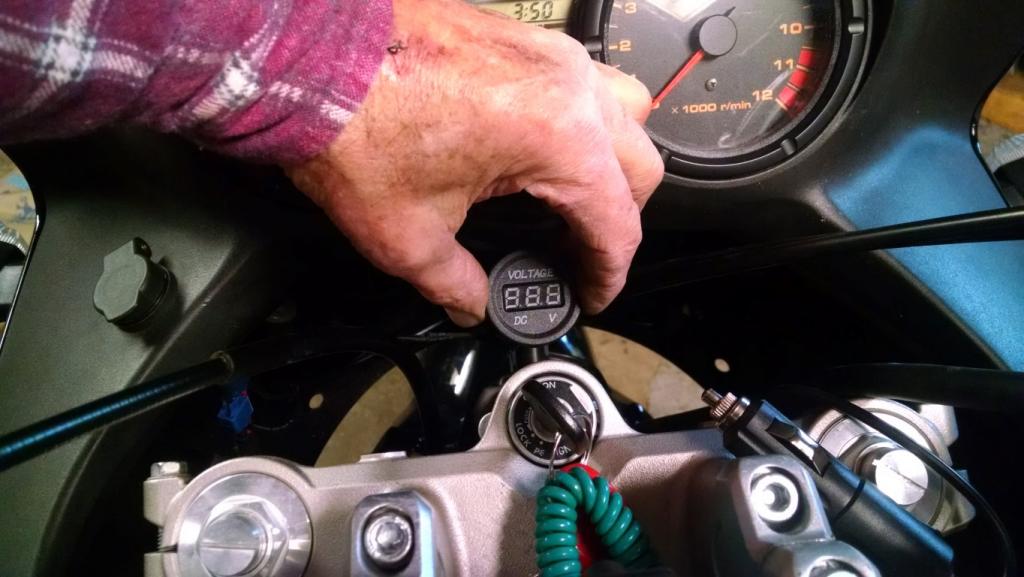

eagleeye Posted December 15, 2015 #10 Posted December 15, 2015 This is the voltmeter that I'm putting on my vstrom. And my buddy has a bunch of bikes and he just ordered a dozen of them and they are going on all of his bikes. I think around $4.
garyS-NJ Posted December 15, 2015 #11 Posted December 15, 2015 I bought a cheap little Chinese dvm for my buddies boat and it's off about 0.5v. Also blue digits at night affects night vision. Get red digits. And I'd have it connected to ignition voltage when you turn the bike on... you can always probe the battery too. Lastly it won't accurately show battery voltage while cranking starter like an analog meter will do.
