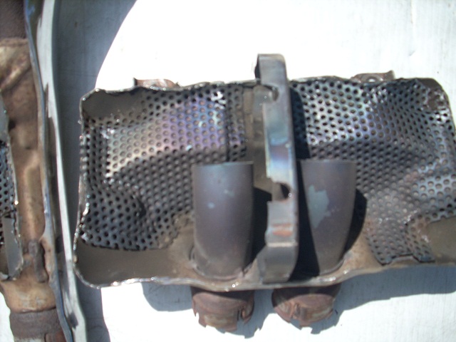

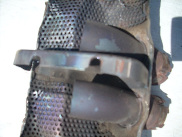

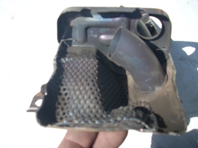

Some pics of the collector internals:
[ATTACH=CONFIG]102574[/ATTACH][ATTACH=CONFIG]102575[/ATTACH][ATTACH=CONFIG]102576[/ATTACH]

Well I guess at some point I will switch out the collector which I might do since I have another one I can prepare for replacement ahead of time. Then I can cut the old one open and see what is going on inside.

So are all those parts really necessary for the bike to run properly ? If I cut it open, do I clean it out or fix it all up ? I know the carbs are temperamental with the air cleaner and air intake is tuned/calibrated, but is the exhaust also special in the fact that it has to have this crap in the crossover ?
I know other pieces are someway loose as it rattles when I first start it and it is cold. Don't really hear it when it is warm. :confused24:
You can open it open and remove anything that is loose or may become loose. It won't hurt the performance. May even help.
Note that there is an aftermarket "collector" that does away with the box altogether, (think Hooker header). That "header" has way less restriction than the stock system and yet rejetting seems not to be required.
I don't know that any of it's necessary. It was always my understanding that a collector would help to muffle and even out the pulses to smooth out the sound. Kinda like an anti-Harley effect.,....plus it equalizes back pressure to all cylinders so they're all running under identical conditions, assuming all other functions are synchronized.
But that's just what I've always thought.....I'm sure someone here will explain why I'm wrong....:moon:
