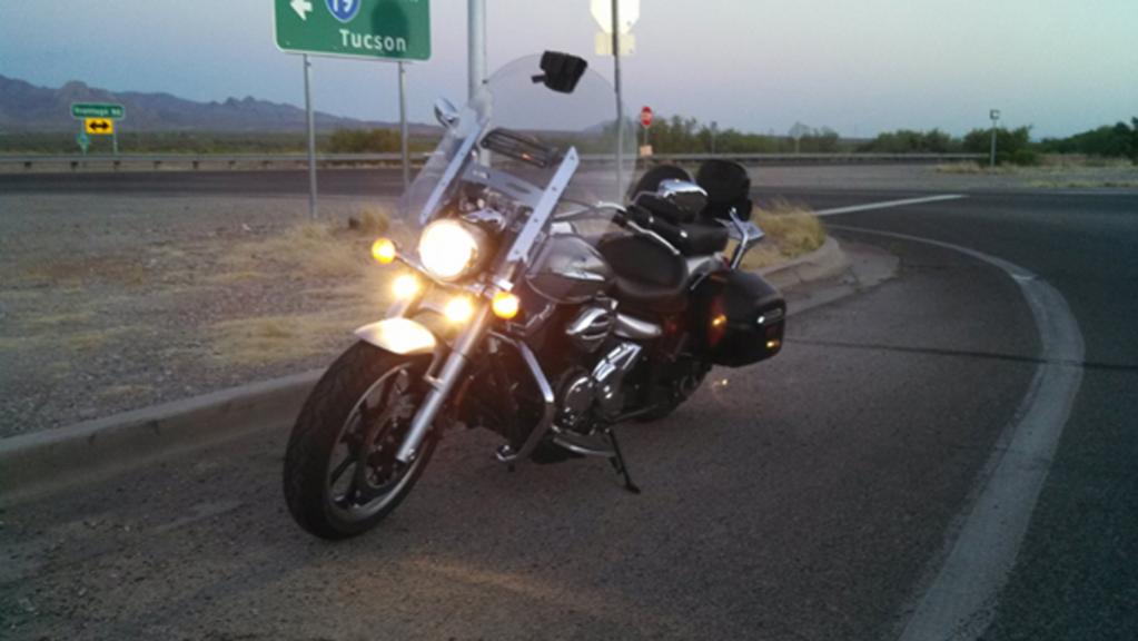

videoarizona Posted December 3, 2015 #4 Posted December 3, 2015 Agreed. I bought the same lights and put them on my VStar 950T. I swapped out the stock bulbs with 20 watt versions. They work fine. Lots of light at night that I have aimed to the side a tad and good visibility for cagers during the day... You will like those lights. PS I think Ikea may have LED versions of those bulbs as well...but don't know how much power they have... This pic is with the 20 watt bulbs in... OH...last thought. I drilled a tiny hole in each front housing and put a tiny screw in the hole. Did that to hold the front element to the body better. I used the little punch dimple to drill the hole.
