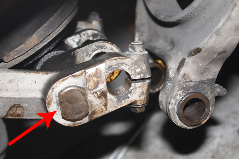

IMG_9291.JPG IMG_9302.JPG IMG_9292.JPGIMG_9293.JPG Double type linkage. One small bolt on right side that came out but is way too short to do anything. It does easily thread in and out. Double heads on the left side are just what you see above. No way to turn them. The outer "bolt"(?) has a clip, but that doesn't release the bottom of the shock. :doh:

Sure looks to me like if you popped that snap ring off in pic 4 and slid the washer off that is behind it you should be able to knock the pin out that the clip is attached to. Then swing the arms down to remove the shock.. It does indeed look like some form of a lowering link, never seen one before on a 1st Gen but have seen some very similar on my dirt bikes..
Might wanna clean the area around the clip real well so you dont drag dirt into needle bearings and all that. Also, be careful what you rap on that pin with so you dont mushroom the end of the shaft..

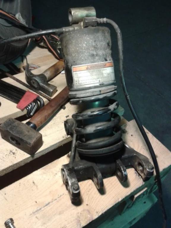

Well I soaked all the nooks and crannies with penetrating oil last night and this morning. Then I went and bought a 5-inch 10mm X1.25 X5 bolt that was a longer version of the bolt I removed.
I then screwed the bolt in as far as I could and then introduced the bolt to Mr. Sledge Hammer. It took some convincing to get the rod to vacate it’s current premises inside the linkage. I only needed to get the rod past the outside of the lower shock mount and not all the way out. The shock was then removed.

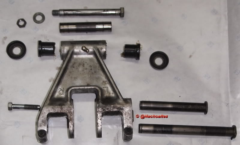

I did find that one side of the bushings were worn and broken, while the other side is in pretty good condition.
