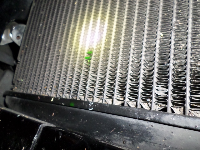

mirider Posted November 18, 2015 Author #8 Posted November 18, 2015 Did a little poking around under the bike this am and wasn't too happy with what I found. As shown in attached pic, it appears I have a small leak in two adjacent fins of the radiator. Not pouring out, just a drip so can I assume I have a crack in the fins and if so, what the heck would cause that. Doesn't appear to be any impact damage and as I stated before, haven't ridden it in a while and no leak noticed until the other day. :confused07: Any thoughts ?
Flyinfool Posted November 18, 2015 #9 Posted November 18, 2015 That is an odd place for a leak with sign of impact damage. Time to snag a radiator pressure pump to track it down. Maybe that spot just got splashed somehow.
cowpuc Posted November 18, 2015 #10 Posted November 18, 2015 ,, that is kinda strange, I haven't heard any kind of scuttlebutt on bad radiators associated with our scoots.. Lord only knows what caused it, maybe a bad seam or a weak spot in the aluminum on a vein.. No idea how expensive a new rad would be but I would not be surprised that a rad shop could fix that fairly easily - hardest part would be getting it in and out.. Well brother,,, at least that gorgeous scoot of yours was kind enough to hold off till the very end of the season to decide it wanted some extra attention
vzuden Posted November 18, 2015 #11 Posted November 18, 2015 Make sure it is not leaking above that spot on the radiator. The fins can catch and retain every little droplet

mirider Posted November 18, 2015 Author #13 Posted November 18, 2015 Could be Big Mac(Puc's name for my scoot) is just po'd cause I put her away for the winter.....:crying:Guess I will wait til spring to do a more thorough investigation to determine the source. Kinda cold to lay on my back on the garage floor with a flashlight and I placed a catch container under her to monitor the loss.
