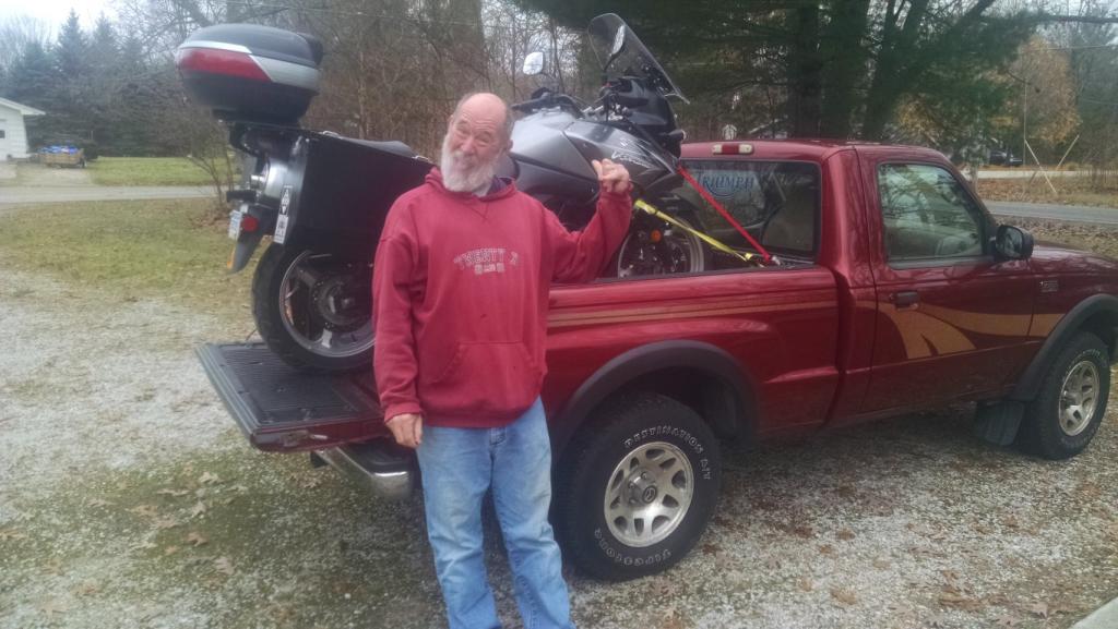

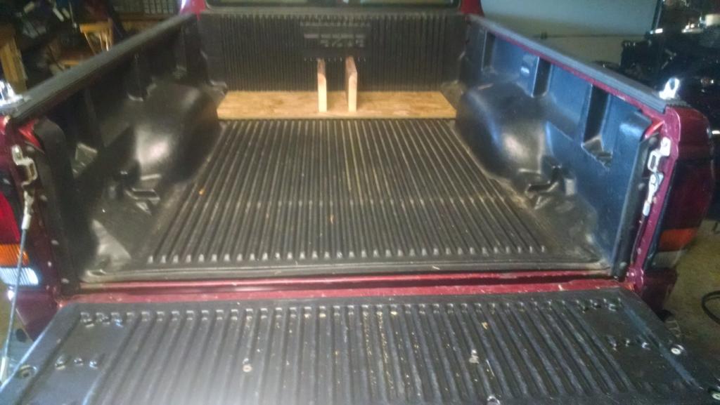

eagleeye Posted November 7, 2015 #13 Posted November 7, 2015 Here is what I made for the vstrom I picked up: OSB with 2X8's 4" ID for the tire width and two straps per side an a strap on each rear. Puc is showing you this.
Condor Posted November 7, 2015 #14 Posted November 7, 2015 Vzuden and Condor, do your bikes have standard sized Venture tires: 150/80-16? I'm running stock sized E3's....
Condor Posted November 7, 2015 #15 Posted November 7, 2015 Here is what I made for the vstrom I picked up:[ATTACH=CONFIG]102261[/ATTACH][ATTACH=CONFIG]102262[/ATTACH] OSB with 2X8's 4" ID for the tire width and two straps per side an a strap on each rear. Puc is showing you this. Actually we loaded it off of a hill/ledge and was even with the bed, and the harley shop a couple blocks from my house helped me with their ramp, again, rear wheels low and a BIG, WIDE curved ramp. Nice idea, but to take it one step farther I'd put triangular gussets in the middle of the 2x8's just to give it a little more support. With the side pieces only attached at the base if something happened... strap break, etc.... there wouldn't be much support to keep the bike upright. I did something similar when I first started bringing stray Ventures home. Only I used 2x4's to form a channel with a 4x4 acrossed the front to keep the bike from moving forward in a panic stop...plus lots of straps. BTW...Very cool looking scoot...
eagleeye Posted November 7, 2015 #16 Posted November 7, 2015 Triangular gussets are a good idea, and I had thought of it, but I had plenty of long screws in the thing to hold it together, and I ALWAYS use two straps on each side of the front, for that very reason.
